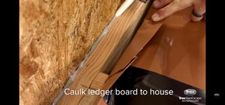

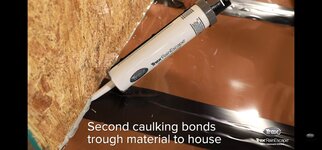

ummm, if you are not going to take instructions from a big company that has been involved in 100,000 thousands of deck what do you expect to get from GJ? I am curious.
This is just bad practice, you are likely expected to buy the additional flashing and never do it this way.. but they are suggesting it's appropriate as a complete solution, and it's not.
Screenshot_20231004_093613_YouTube.jpgScreenshot_20231004_093628_YouTube.jpgScreenshot_20231004_093643_YouTube.jpgScreenshot_20231004_093648_YouTube.jpg

Your picture post of their technique is a very poor installation video. They say in the audio that this technique is for special situations like brick, yet theyare showing OSB. You is not one of the special cases.
Having re-read the thread your initial post is ok. I would however add a 6 inch galvanized "L" flashing. Decks move from settlement storms etc. A nailed flashing covered with EDPM will retain water tightness.
