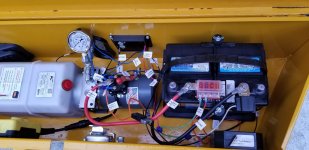

My Sure-Trac doesn't lift as much as I believe it should be, so I just added a pressure gauge to my system.
The KTI pump is rated for 3,000 PSI, but for whatever reason, Sure-Trac set it to have a maximum of 2,500 PSI. I believe that is my main issue with not being able to always lift to the rated capacity, but unfortunately it is not adjustable. I need to get a hold of them to see if they are willing to send me out a new relief valve.
I've a picture of the new pressure gauge I recently installed. This gauge states I max out at 2,600 PSI, as opposed to the 2,500 PSI Sure-Trac tried to adjust it to. Not sure how accurate the gauge is, but either way, I want to get it closer to 3,000. You may want to consider adding a gauge yourself, if you haven't already planned on it.

I've also attached a photo showing all the labels I put on the wires on Friday at the same time I was installing the Blue Sea Systems ST-Blade Battery Terminal Mount Fuse Block Kit on the battery.
