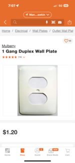

Are the Mulberry metal ones still a thing. I always preferred those.
sparky 1971
Oct 9, 2018
7,967
Central Iowa
It must be a regional thing. What I've always referred to as a Mulberry was a metal single gang plate with a 7/8" hole (1/2" knockout) in the center. As far as metal plates go, they are still around but for the most part, other than stainless steel, are considered more of a decoration type. The others may be out there, but I haven't looked.
