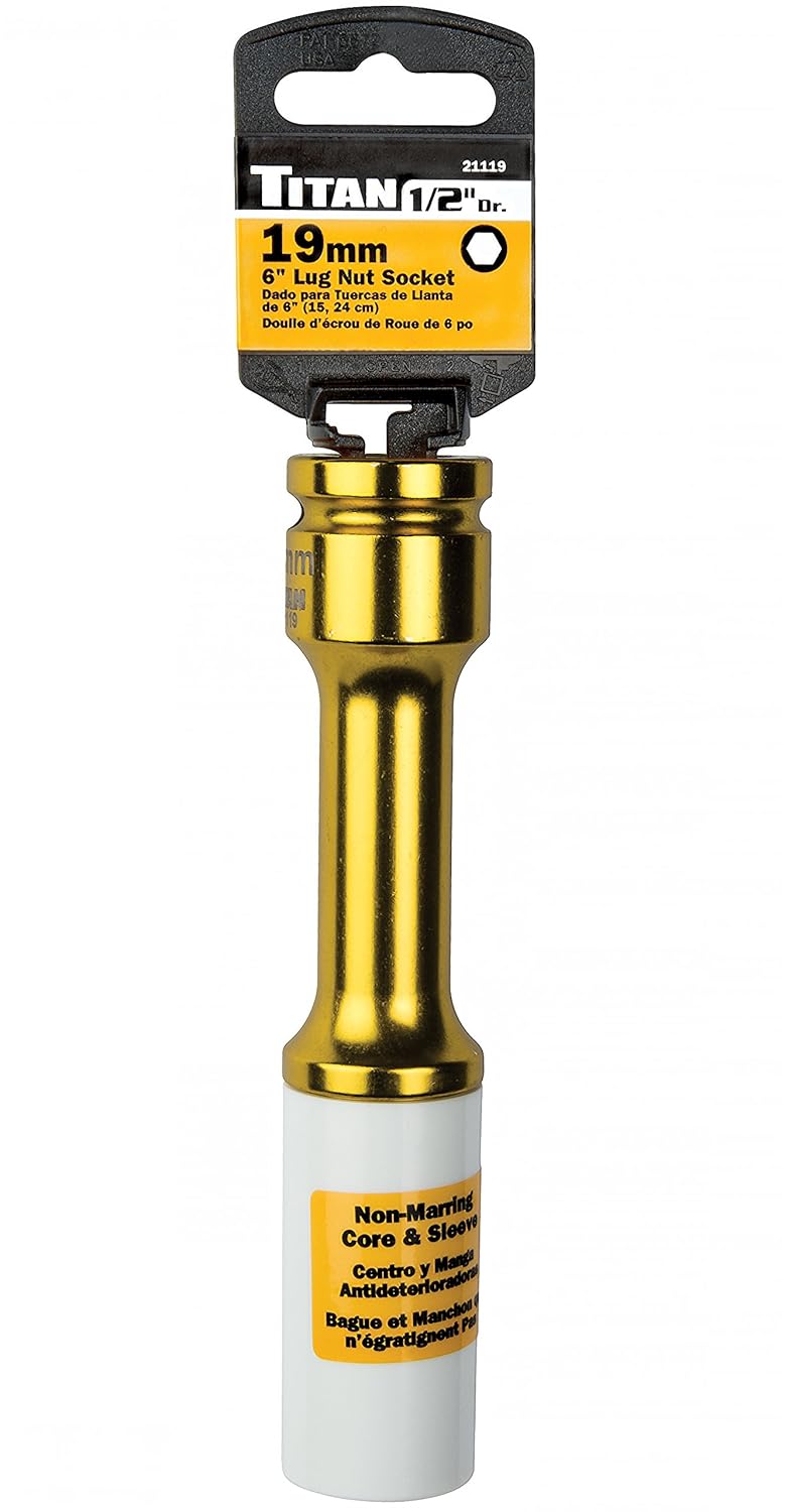

Tonyuk
Jun 9, 2017
1,539
Scotland
Mine are from Facom, and are pretty much identical to these;
The extra length really helps prevent scratching an alloy wheel.

nmantas
Sep 18, 2010
828
Downriver Detroit
I'm thinking of getting some of these, wonder if the Facom, Sunex, Titan, PCL sockets come from the same plant. They all look identical except for the exterior finish and sleeve (Sunnex set is $60):
