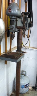

I've picked up a decent Delta table top model drill press for small work , nice condition albeit missing the clock spring ....ugh .
Need to figure out what the age is and any specifics I can get about it . The old girl is nice and tight except quite a lot of runout at the chuck as it's worn . I'd guess it spent it's life doing wood or something all other things considered .
Looks like the clock spring cap diameter would be about 2-1/4" with two 5/16" locking slots . Shaft is 1/2" diameter with a slot for the spring itself .
I've seen a few for sale on the 'net , but no real dimensions and I'm curious if there were any changes made over the years ??

Your 14" DP an early version. Technically, the DP 220 is the head casting number. The switch, motor and mounting bracket are not original. As to whether there were changes in the return spring, those over on the Vintage Machinery site http://www.owwm.org/ are keepers of such minutiae and if you have the serial number, they can give you the production date. Before you join, read their numbered rules. There are many and they are strict in their policing thereof.
FWIW, it appears your DP may have one of the optional spindles; possibly the 1/2"ID for use with mortising chisels. Delta made a half-dozen quickly interchangeable spindles; JT33, MT2, 1/2"ID, threaded, et al. I prefer the JT33 for all-around use, so you might also be on the search for one of those.

Yeah - I've seen that board and looked at some of their pics for a short time and have heard how they treat their members . I don't usually ask simple questions anywhere as I know better and understand if you don't at least do the basic research leg work you don't belong . Newbie stuff only goes so far and some places it's not tolerated at all . Dictator-run sites are off my list of places to visit , they can keep to themselves .
@454ragtop - if you have a clock spring/cover I'd be interested - let me know or I can send a pm . I'm usually pretty good at finding parts and doing research but this thing has very little details out there .
That chuck adapter is a problem and doesn't appear to fit tightly - need to get time and investigate it further . If it's a straight shank type I'll swap it out for a taper style in JT33 or something .
I see no hints of a serial number anywhere on this machine , unless there was a stamped tag on it at one time - nothing now and no other numbers except the cast model numbers . I suspected it was an early version and glad to confirm that . I assume probably 1940's..?

I've seen some pretty wild conversions done on some of these old vintage machines - amazing what some folks can come up with . Never a CNC DP-220, though..lol .
I may just make a new spring and cover - the machine is only for light work and I'm hunting a heavy 20" or so unit to replace the current 17" POS Craftsman that I have . More runout than a Model T on that thing and I'm not replacing the wobbling spindle again . Light jam on one tapered bit in it and it's done...way too lightly built and no decent tolerances .
I need a mill , really - just don't have the room if you look at the pics of the shop I'm stuck with right now .
Appreciate all the feedback , wish the dumb serial plate was still on it but it really doesn't matter when it was made - it's good and tight yet and totally repairable and will suit what I wanted it for nicely .

The OWWM.org rules ARE somewhat constricting. Obviously none of us like being told what to do (or how to do it). I have found that I can abide by their rules if I keep in mind that the people who frequent there are really great people, and their knowledge about these old machines is incredible. This is a superb resource for those of us who want to restore old machines but don't have the experience to "just do it". I have restored several machines and I owe 99% of my success to the guys (& gals) at OWWM. They make it worth tolerating the rules.
Oh, and here is my DP 220, awaiting restoration...

Your handle is the same style my 1944 model has. If you have spare belt covers, there are people on here who are looking for parts, as one has contacted me. Looks like the head spindle cover is differently-colored from one pic to the next (grey vs. green) which is what I saw.
