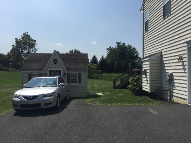

Almighty garage warriors! I come to you to draw upon of your great garage building electrical knowledge.
Long story short, I am building a 24x28 detached two car garage about 15' from my house. From an electrical load perspective, I am looking at...
  • Two 15A lighting circuits
  • Two 20A wall outlet circuits
  • One 240VAC 22A circuit for Air Compressor
  • One 220VAC 25A for 2-post lift
  • One 240VAC 30A for welder
So the rub... The house currently has 200A service that is pretty well utilized after we finished our basement.

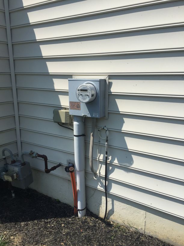

In speaking to a field technician from my local power provider (PPL) they mentioned about adding a second meter socket to the house, utilizing the existing underground feeder. (Permitting my proposed additional amperage load is acceptable and not needing to increase the wire size of the feeder)
For 100A service, does that make sense to you or would adding a 100A breaker to the existing 200A panel make sense?
Thank you in advance! :beer:

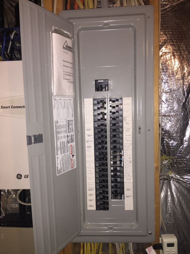

Thanks for the quick replies! In doing two 200A panels... It is my understanding that if they are both 200A mains and bonded at the meter lugs that the meter then needs to be upgraded to 400 (320). Is that not true? I'm definitely going to find out our average amp load.
Another option I have considered to clean up the existing main panel and then do a 125A breaker to feed the garage sub-panel. I also don't intend to run high current equipment concurrently. I'm only one person tinkering in the garage ;)

Looks like you have 2 available spaces in the bottom if you go that route

Most likely, the utility company wouldn't be increasing your power availability by setting a second meter. The transformer and service cables would stay the same.
In my opinion, the only way a second meter would make sense, would be if they would allow it on the garage, so you didn't have to trench your own cables.
