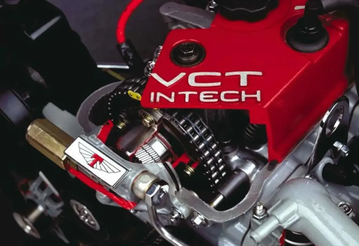

For the non-Aussie members here, the Intech was the final evolution of the Ford Falcon SOHC inline 6 engine before it became the DOHC Barra. The basic and HP versions of the Intech weren't really all that different to the previous incarnations, they even produced the same 157 kW / 357 Nm and 164 kW and 366 Nm from the previous model. Most of the changes were made to increase refinement, but if I'm honest, while the Intech was smooth up to about 3500 rpm, they were wheezy and rough up to the 5750-rpm limiter.
My first car had the standard Intek, which used a raw aluminium rocker cover. The HP version used a revised cylinder head and camshaft, which was developed by Tickford and used in the XR6 HP sedan and Ute, identified by the red rocker cover. There was also a green rocker cover, which denoted dedicated LPG (propane).
Ignore the aftermarket headers fitted to this example -
Ford and Tickford worked to develop a more powerful version of the Intech. They looked at both turbocharging and supercharging, but nixed those ideas due to cost. Instead, they developed a revised cylinder head to accommodate a VCT system (variable valve timing). In theory, this sounded like a high-tech solution to providing more power. To make the financial case stack up, in addition to creating the XR6 VCT sedan (the ute would follow a few years later), they fitted this "premium" engine to the luxury Fairmont Ghia and long wheelbase Fairlane Ghia. The VCT engine also got a red rocker cover, but it was a different casting and featured silver accents. This is one the sexiest looking Falcon 6's ever made....................................
Considering the cost that went into creating this unique cylinder head, the actual increase in power and performance was tiny. Because there was only one camshaft, the rage of timing adjustment was limited. The Fairmont/Fairlane produced 168 kW and 370 Nm, the XR6 with a less restrictive exhaust made 172 kW and 374 Nm. That represent only a 4 to 8 kW increase over the standard HP engine.
Compounding this feeble increase in output, an XR6 VCT was significantly heavier than the base model XR6 HP due to the fitment of double wishbone IRS. The result being the cheaper XR6 HP was faster than the more expensive XR6 VCT. Same applied to the Fairmont vs Fairmont Ghia, the base Fairmont had a live axle, the Ghia had the heavier IRS.
The VCT system didn't make the engine smoother up top either. None of these SOHC engines could come close to that sweet rasp and butter smooth running of a BMW inline 6. Instead, you got a lot of mechanical valve train thrash and an unpleasant wheezy whine after the intake manifold switched to the short runners at 3500 rpm. Below that 3500 rpm, they were smooth and rich with torque, ideal for towing and long distance travel.
The early 3.9 and 4.0 versions of the SOHC engines were plagued with head gasket and cooling problems. However, these final Intech versions were incredibly reliable, easily capable of a 500,000 km and beyond.
