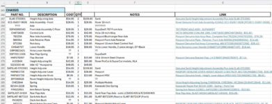

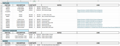

It's taken me a while, but I've got most of the NOS parts haul entered into a spreadsheet.
Not all of it has been cataloged. For example, two bins of assorted hardware with and without part numbers. The box full of paper gasket kits I chose to ignore for the moment as I'm not sure how usable they would be after 40-years. You'll notice in some instances a part didn't have a number, which meant not finding a price or what it suited. In some cases, I simply couldn't find any reference to particular part online, especially the SupaSwift stuff.
I bought these parts in two lots, all up costing $500. Even without every single part being logged and priced, the total value so far is just over $14,000! Now, the key word there being "value", I doubt I'll see a full return on that figure. Some of it will be virtually useless, some won't command a full retail price, some of it not even worth selling. I've also started drawing on it for my own use, such as a Victa Pro Control throttle lever and cable assembly, and certain stuff will be used for a planned restoration at some stage in the future...............if I ever find a suitable candidate.
