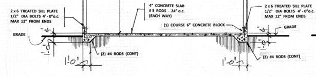

Hello,
I am (was) planning on building a 16' x 28' gambrel roofed shed (with loft). I have already poured a mono slab that is 10 inches thick x 12 inches wide around the perimeter to support stick built walls. The floor between the perimeter is and approximately 5-6 inches thick. The perimeter "foundation" is reinforced with two vertical rows of #4 rebar and the slab is reinforced with #4 rebar in a 2ft x 2ft grid, wired together.
I am in CO, so we get freeze / thaw. The soil compacts well (silty, sandy, clay).
I am concerned that there may be too much movement for a building of this size and weight and I should have either drilled piers below frost line or a full perimeter foundation down below frost line (was trying to save money).
Do I risk building as planned or would that be a huge mistake? Any advice would be greatly appreciated!

I think you are fine. You poured a thickened edge monolithic slab. Did say what he was concerned about? Did you insulate under the slab? If the building will be heated then you need to make this a Frost Protected Shallow Foundation (FPSF). You need 2"-4" of insulation on the perimeter of the slab and a 2' (preferably 4') wide perimeter insulation around the base of the foundation. FBSFs are in the building code, so if they give you are hard time, show them the code. I have a 36x48 shop and a 2300sq/ft ranch home built this way. I'm in MN. Built in 2017. It works! And we have a high water table. Lot's of guys on the job site, told me this won't work. Well I can tell you very confidently that it does.

I am in Minnesota. Garages here are done all the time with a slab as you described. My local city approved the plans for my concrete slab. I included a section from my plans of the concrete slab that was poured for my 24'x60' building.
