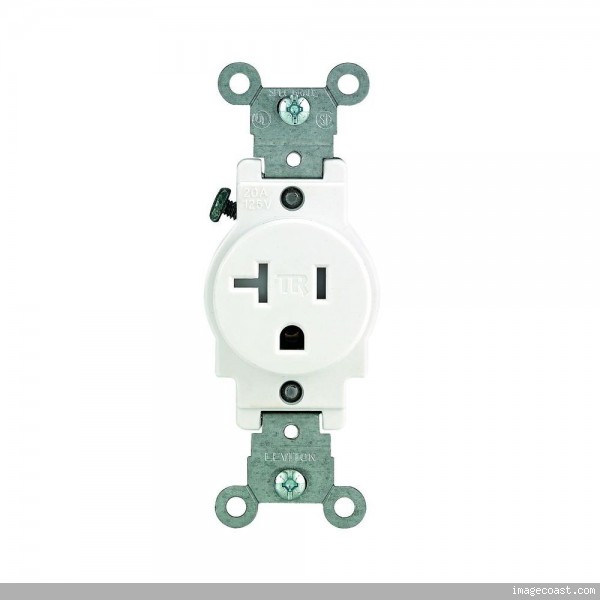

So I went back and bought a 20 amp plug wired it up and nothing, it doesn't turn on the welder.

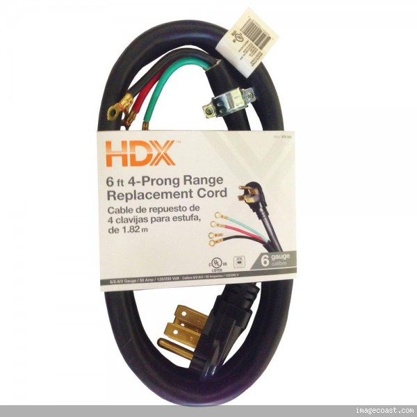

Screw it, I did a little research online and most welding forums from what I could tell just advise to make a cord and wire it to a breaker, so that's what I did but not sure if I did it correctly or if its safe. Everything works great, no smoke was let out of any wires. The welder seems to work much better and all is good so far.
This is the outlet, plug, breaker and cord I used. I didn't want to use the existing 220 because when I test it with a meter it seemed dead, there are wires going to both 220 breakers but only one outlet (the one for the dryer) is working, I'm guessing the breaker for the other 220 is bad. I also didn't want to wire anything I couldn't easily undo when I decide to sell the house.
So I basically have this cord, I cut that dryer or range or whatever end off with a cut off tool. Then I ran the green to ground, used the black and red as hot and cut the white one, I put some liquid electrical tape over the end then taped it up to the rest of the cord

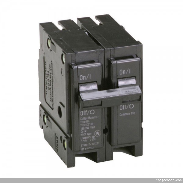

I ran the cord to the electrical panel in the garage to this breaker, hooking the black and red to the breaker then the green wire from the cord to the ground bracket in the electrical panel.

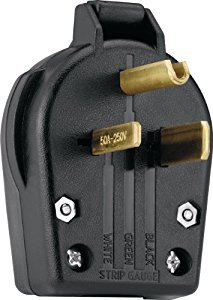

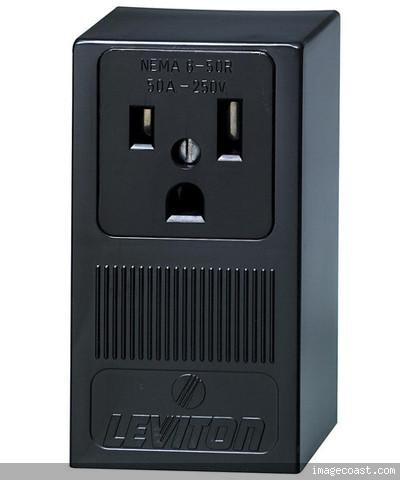

I wired the other end of the cord to this
Then I wired this to the cord on the welder

Is it safe? Probably. Is it correct? Heck no. Stranded wire should not be connected directly to a breaker
I have never heard of this. I have seen several commercial buildings with stranded thhn hooked up directly to breakers with no issues and that have passed inspections.
slodat
Feb 6, 2010
3,679
Central-ish, WA
Is it safe? Probably. Is it correct? Heck no. Stranded wire should not be connected directly to a breaker and you have used a 110 volt plug and outlet instead of the correct 220 volt.
A NEMA 6-50 is 250v. THHN is landed on breakers all day every day. Don't lead the guy astray.

What you did was okay, and safe. Not 100% proper; what should have been done is you would hook up the white lead to the neutral bar in the breaker box, and you should have wired the welder with a 4 wire plug, and used a 4 wire outlet instead of a 3 wire.
The welder should have two hots and a neutral terminal. You want to make sure you DO NOT hook up the ground wire to the neutral terminal, otherwise you have the potential of carrying current on the ground. You want that current to travel on the neutral, not the ground. The ground wire should be grounded to the frame of the welder.
If the welder is older, or has no 120 v components in it, then it may only have two hots and a ground, and no neutral. In that case, you should still hook up the neutral in the breaker panel, and run 4 wires to your outlet. (red, black, white, green) At the outlet, you would wire the 4 wires to a 4 wire receptacle. Then, you would wire a 4 wire plug to the welder, but would have no place to hook up the neutral. You would just hook up the two hots and the ground, and cap the neutral with a wire nut.
The reason to do this properly is that you may want to power other things from the receptacle. Another reason is that you want to properly carry any 120 volt power on the neutral from the welder; this may or may not be applicable depending on how your welder is wired. If it is truly a 3 wire appliance, a better way might have been to directly wire the cord to the welder, and eliminate the 3 wire outlet receptacle that you used as an intermediate to the welder. Then, the circuit would have been a dedicated circuit, and proper.
I was thinking about leaving that range or whatever plug on there and getting a receptacle to put on the welder but I didn't know which color wires were going where on the plug and by cutting off the end and just using the cord I could use the green for ground and the other colors however I wanted without worrying.
The welder is definitely only 3 wires, there is a blue, a tan/green, and a brown. It didn't even come with any type of plug, I guess because its both 110 and 200 depening on the plug you put on there, then there is a power switch for 110 or 220. I accidentally switch it to 110 while on the 220 breaker and the welder buzzed unusually loud and my wife came out and asked what I did because all the lights got really dim, lol. I never plan on using anything else on that circuit and when I do upgrade to a better welder I'll just pay an electrician to come out and either fix the other 220 outlet or wire this one proper.
Another weird thing is all the neutral wires and ground wires go to the same bar on my electrical box. Online it seemed like there should be 2 separate bars. I did find one thing online that said sometimes they share the same bar. I also couldn't find any difference between the grounds and neutrals, like different screw colors or anything.
I knew it wasn't proper and a little jenky, I just didn't want to run wires behind the wall or anything when I didn't really know what I was doing and hurt a future owner or worse down the line. It sounds like the cord I used might also be wrong or a little small. I just got one what was at least 240 volts and 50 amps. That plug I got for the welder also came with different contacts one was 30 amp and one 50. I used the 50 amp contact.
It does look all sorts of wrong with that cord sticking out of the electrical box lol. I unplug the welder when I'm not using it and cut off the breaker, not sure if that makes it any safer though. I was thinking about pulling the breaker each time, the only drawbacks to that is, that ground is kind of a pain to get on and off and I kill the main power any time I mess with it.

Its not 120/240 but either 120 or 240, dvi It came with the right cord, the owner is to put the one on it they are going to use. Should be a 6 50 for a welder.

Dave, wtf are you talking about? His welder came pre-wired with a 3 wire cord. It is capable of running on 120v OR 240v, not both at the same time. The 3 wire feed is proper for a dedicated 240v appliance. Pretty much any power tool (welder, table saw, dust collector etc) will only require a 3 wire 240v feed, as there is no 120v load within the tool. Sorry to be harsh, but I think you are taking advice related to 240v appliances (stoves, dryers etc) that have 120v loads and trying to apply it here, which is wrong and misleading.
OP, I think you are good. I went back and read again to make sure. My current setup is very similar, except I used a piece of 6-3 NM B from the breaker to the 6-50R. I plug my welder into that, and if needed, I swap the factory supplied cord out and plug it into a normal 120v outlet. Both cords only have 3 conductors!
