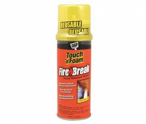

Well yes it meets code as far as fire blocking which is all that’s required in residential. It doesn’t have to be fireproof like commercial work
I know. I was trying to share some info with the OP, as he doesn't seem to be familiar with insulation. If it was sold as fire retardant, he should know that it is noy

Was the spray foam they used orange? That stuff isn't actually fire retardant, it's just colored to make it visually easy to identify that gaps were sealed for inspection
You're saying the orange stuff labeled fire retardant is not a fire retardant?
2KVH8_AS01
Read that label again. It doesn't say fire retardant.
"Resistant is defined as a material that is inherently resistant to catching fire (self-extinguishing) and does not melt or drip when exposed directly to extreme heat. Retardant is defined as a material that has been chemically treated to self-extinguish."
2KVH8_AS01
I read somewhere it was the same as the great stuff gap foam....just colored orange and a good bit of extra money per can.
I lit both on fire and they burned like 10 year old kindling.
Total bs.
Total bs.
The fire portion is based on stopping air movement like blocking walls over 8 feet.
Sent from my SM-G960U using Tapatalk
You're right, same stuff, plus orange color. Supposed to help in inspections
Total bs.
Correct, which is all that is required in residential construction is all penetrations must be sealed with fire locking foam. Nothing has to be fire proof or fire retardant.
My point was great stuff makes the red can (gaps and cracks) in the pro can for $11 which is approved as a fire block foam. And they make the fire block foam in the orange can ($23) which is also approved as a fire blocker but costs a ton more. They are both orange when dry and work the same
