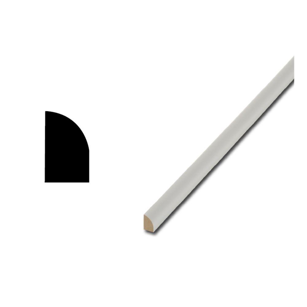

Also don't forget the shoe moulding. Don't use regular 1/4 round. Shoe moulding has a less bulky profile and looks way better. It covers the gaps and gives the baseboard more depth while protecting it.
And don't forget to cut the caulking along the drywall with a utility knife before removal so the paper doesn't tear. This is where shoe moulding is once again beneficial as you should be able to raise the new baseboard a tad to cover the the score line and old caulk.

You might want to look into using white 1/2" pvc quarter round at the floor line. Glue it to the base board using Loktite or similar in caulk tube form. Don't glue it to the floor because your floating floor needs to move. No finishing nails or filling and painting required and it looks good. It also makes for a fast installation. Available at the big box stores.

I've already removed all the trim otherwise I would look into it. I found a local supplier that has 4 1/4" x 16' sections available pre primed so I think I'll be picking that up
