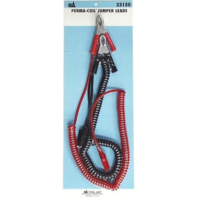

As for the PP circuit power function this is easily accomplished with jumper leads or by using the Lisle32900 which has a Jumper button that turns your test light into a power jumper to activate relays or power test components with the press of the tiny red button, it's only $17 and has incandescent bulbs available:
Lisle 32900 Heavy Duty Circuit Tester and Jumper, Red https://www.amazon.com/dp/B000TTFWX2?tag=atomicindus08-20
Here's the perma coil jumper leads for power testing components:
It's only $17 and way cheaper than a $100-$180 Power Probe. They all have their uses but I've never needed my PP.
These would be more useful if they were 25' long a had banana jacks !
