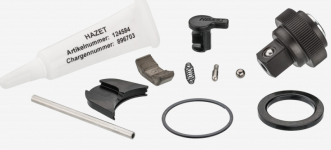

So I'm thinking it works like this.
You can lower the amount of force required to push the pawl back to allow the ratchet mechanics to occur, by replacing the stock springs with springs that require less force to compress, this will decrease back drag. At some point, the amount of force will be too little, and malfunction will begin to occur, and when you start to go in the reverse direction, instead of preventing movement it will skip. So we have to find the sweet spot. We can do trial and error. Not sure if there's a way to calculate it.
I think grease will provide better lubrication and longer lasting, in-between re-application over oil. However, it will have a higher coefficient of friction, increasing back drag. This is because you will have a semi-liquid solid to plow through, requiring more force to engage the next tooth, had just a liquid lubricant.
Oil will drip out and will require more frequent lubrication, and offer a lower coefficient of friction (in most cases).
One thing I cannot wrap my head around, is why is back drag less on an unlubricated ratchet (dry) over most oils? I've tested this myself, and yes, it's true. I don't understand this. One would venture that you would have a lower coefficient of friction with an oil film between two pieces of metal, over metal rubbing against metal without any lubricant. But the collected data says otherwise (for most oils). Or maybe we just don't understand what the data is suggesting, maybe something less obviously. But what? I am having some difficulty understanding what we are observing here. Any guesses?
You posted a chart on page 2 and the chart you posted doesn’t corroborate your statement. Light oils all resulted in lower back drag than a dry ratchet. And Lord knows what ”dry” means. As @Hohn said, even a drop or 2 of oil makes a difference. If you were testing back drag, you'd have to soak parts in acetone to really get them dry.
Remember, the purpose of lubricants in your ratchet head isn’t just for back drag, it’s to prevent wear. There are finishes inside your ratchet head. Those finishes are there to prevent corrosion. So you want to protect those finishes.
At the end of the day, I would offer the following advice:
  1. Back drag isn’t a concern for every single ratchet. Generally, long ratchets are used for their leverage. Back drag is fundamentally important after the hardware has been loosened. I often switch ratchets or just work hardware out by hand.
  2. Everyone should have something I call an ”installation” ratchet. It could be a round head, or a 3/8” ratchet in a 1/4” body. I use these primarily to install hardware, finishing with a torque wrench when necessary.
  3. Back drag reduces over time. Ratchets are gear boxes and gear boxes wear. Because wear takes place, you really should change your oil just as you would in any other gear box.
  4. Modifying a ratchet to reduce back drag is probably a waste of time. Messing with the spring can easily do more harm than good. The best way to improve a ratchet is to polish the gear teeth, but this can be time consuming and may only produce modest or imperceptible benefits.
  5. If you want a high performing ratchet, buy a high performing ratchet and lubricate it per the manufacturer’s advice. If there is no advice or the ratchet doesn’t come pre-lubed (unlikely if you are buying quality) CLEAN the body and mechanism to thoroughly degrease. Re-lube all components with a high quality light oil, and grease with a light compatible grease per my instructions. If you aren’t sure what to use, to ensure you are compatible with whatever seals you have, use Superlube oil and NLGI 00 SuperLube grease.

I see what your saying and thanks for pointing that out. It seems like the ones that were higher than "dry" were thicker oils, and possible fit into the cateogry of "grease". Supporting the idea that grease will increase backdrag.
Also soaking in acetone, would act as a degreaseer? So just submerge in liquid acetone, and then pull out and wait to get to the "dry" state?
I understand that your saying messing with the springs could do mroe harm than good, could I just ask why you think this?
Also are you suggesting to use both grease and oil? I have been contemplating this combination. I'm thinking grease underneath the gear and pawl would ensure that it's lubricated longer, and wouldn't risk gumming up the teath. Just enough grease to lube up the underneath surfaces of the objects that move. Oil could go elsehwere on the teeth.
This guy does an experiment with greases
And the 00 grease drips out of the whole in the cup, while the 0 John Deer Grease doesn't. He also mentions that the 00 grease might be a little thin. Are all 00 greases that thin? I was thinking if so, then 0 may be better at not leakign out of the ratchet?
I have never seen 0 or 00 grease in person before. Just on YouTube. There's also 000 grease, but it's not cheap.
Thanks for sharing the information.
Also I think you are right, a majority of the backdrag is from springs. So polishing up the internals may have little to no measureable effect. Still would be a neat experiment to try and confirm if it's the case.

I see what you’re saying and thanks for pointing that out. It seems like the ones that were higher than "dry" were thicker oils, and possible fit into the cateogry of "grease". Supporting the idea that grease will increase backdrag.
You posted it and should be curious as to what those materials are. SuperLube 21030 is NLGI 2 grease. This is not the grease snap on ships with rebuild kits.
Also, all those numbers are really small. The difference between 8 inoz and 10 inoz would be imperceptible in normal conditions.
No, I was just trying to make a point. DO NOT soak your ratchet guts in acetone. Acetone is a strong solvent. Point is: define “dry”. Most hardware manufacturers deal with is not ”dry”. There are almost always residual oils/finishes from manufacturing or corrosion inhibiting.
I understand that your saying messing with the springs could do more harm than good, could I just ask why you think this?
I’ve already posted this, pretty sure in this thread. The purpose of the spring is to maintain full contact between the pawl and the gear. If you lighten that spring pressure, you run the risk of losing contact area.
YES. In my opinion, no ferrous metal hardware should ever be dry. And I wouldn’t use grease to wet out my hardware. Look: grease is used in ratchets to reduce friction and preserve finishes at the metal to metal sliding interface. Grease is a physical barrier. Think of it like a Teflon washer, between the rotating gear and the body. If you had no grease and just a light oil, the oil would collect where gravity dictated and there would be no or very little lubrication between the sliding surfaces.
So: yes, you need to oil all the components. I recommend a light machine oil of some sort, then you need to grease under and over the gear with a grease that’s compatible both with the oil and with whatever seals your ratchet has.
Every grease is unique and was developed for specific needs. But all US made greases are categorized by the NLGI (National Lubricating Grease Institute) based on their viscosity. So all NLGI 2 greases have similar viscosities at room temp.
The grease snap on recommends is well documented here and is a NLGI 00 grease, which is pretty soft. While we’re here, just a quick reminder about Superlube. There are mineral based oils and greases with PTFE additives. Superlube is 100% synthetic, so like all synthetic oils and greases, it has a very constant viscosity over a broad temperature spectrum, which is great if you are like me and are stuck fixing cars in 100F summers and 20F winters here in PA.
Back drag is essentially normal force x coefficient of friction. Cutting the springs reduces the normal force. Polishing the gear teeth reduces the friction coefficient. As a side benefit, polished specimens are stronger since scratches are like perforations in a roll of paper towels. Also, smoother surfaces should wear less, since rough surfaces abrade like sand paper.
Pure speculation: the lovely tool nerds at Koken make low tooth count ratchets, with beautifully low back drag. My guess is, they tweaked their springs to get just the right amount of force. I’ll bet that wasn’t easy and some degree of trial and error testing, the likes of which no low cost Chinese or Taiwan manufacturer would have patience for, was required.
Also, whatever manufacturing process they use to produce their gears and pawls probably produces a better surface finish than other makers’ gears. Together, these things are attributes Chiwan makers can’t simply steal and duplicate. I don’t own any Koken tools, but my guess is, their ratchets are special and we likely won’t see their equal from another manufacturer any time soon. I really like dual 80 and like supporting US companies. If I were starting over, I would probably choose Koken just because I admire their dedication, curiosity and attention to detail.
Hope I’ve cleared up what why and how to grease your ratchets. Seriously, go back a read the entire thread. I’m not the only senior engineer here. There are excellent contributions in this thread (and goes without saying, elsewhere).

Hazet
The rebuild kits come with some sort of grease. I cannot find any information on which grease it is. You can see how they apply it in the video. They apply it to the teeth as well.

Hazet
