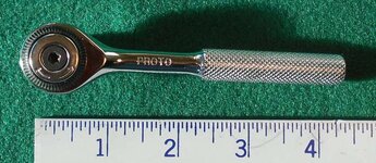

I bought a Proto J5252FBL in April and posted about it. It didn’t get much use until a few weeks ago when I started on a job involving lots of threaded fasteners. I loved using it until one day it just starting acting up. The action became really coarse and it would reverse frequently. Eventually it just locked up.
I took it home and found this:
Seems like a piece of metal broke loose and wrought havoc on the anvil. This seems like a clear cut manufacturing defect, so the warranty should cover it, right?

Is that a 3/8 drive palm control ratchet? where's the rest of the pieces?
The grooves could be wear from the ratchet being adjusted to tightly.
the ratchet looks dry to me. They like thin oil no grease. The ratchets also have a sweet spot. Search palm control ratchet for more posts. They're great ratchets. Sorry things didn't work out for you.

Does the ratchet not function normally after removing the piece of metal?
No, it’ll be crunchy in both directions and pretty soon it’ll lock up. I never found debris I could say was clearly the offending component, I’m guessing it got pulverized. But after cleaning + oiling, its nowhere near the original level of functioning

Yes, it’s a palm control. I have this and the 1/2” long flex. Love(d) them both. I’ll post some photos of the rest of the parts tomorrow.
This was right after cleaning + drying, before some 3-in-1. I took the photos dry to enhance details. Hopefully the repair kit brings it back to “good as new” condition, it is a nifty little gizmo.

I'd expect to see some shiny metal on those area if some thing just happened to that ratchet. That looks like the design of that ratchet would let in debris to wear it out pretty quick. Aside from the entire mechanism cracking in half immediately after buying I wouldn't expect a free 40 dollar rebuild kit on a 40 dollar ratchet. Also it appears that those are made in Europe which makes the delay in getting parts more understandable.

I'm a little surprised that it is jamming after cleaning and re-assembly. I don't see anything terribly off in your photos, although you don't show half the components. Overtightening the torx screw could certainly make it jam, try backing it off a bit and see if that improves things?

What's wild to me is the pictures -literally- show a defect in manufacturing.
