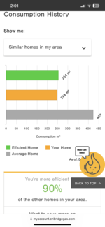

Overall results have been pretty amazing if you consider that natural gas comparative I posted a few back.
I have this manometer which is quite effective, albeit pretty old school. I can pull .04 negative by just firing up the two bath exhaust fans and kitchen hood fan. Anything though will be great just as a comparative. Calculating air exchange without a calibrated exhaust (DIY blower door) though will be a challenge. You would need to take an existing powerful fan, duct it on both sides with say 6-8" feet of straight duct, than use a manometer with pitot probe to take averaging measurements. That would get you a CFM base line.
Or, you can just measure the pressure inside and out with your DIY setup and use it as a comparative as you do work. Just depressurising with a powerful fan will help you find those air leaks quickly.
I do have an older FLIR for iOS which is very effective to troubleshoot cold spots. It's also very useful after spray foam to target leaks for the installer to address...BEFORE they leave the site. I made this mistake on my last renovation...checking for leaks in overhead pot light enclosures after the spray foam guys had left and blown in had been added after. They were not willing to address the problems due to the blown in insulation added after.

There should be somebody (or many companies) doing this stateside. There was a difference of 13 F at the inner surface of a non operating window vs an untreated window with - 10 F outside. There are also images of a small slider (operating window) and the difference is 23 F with and without the panel. They work!
I posted with FLIR thermal images on a very cold day here showing the examples I cited above:
Below image, panel in place:
Below image, panel removed:
