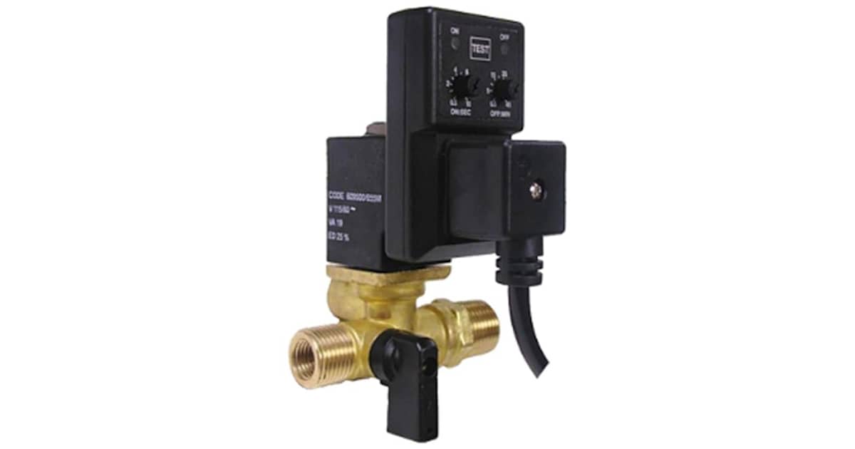

I am looking into this approach for building an auto-drain for my 80 gal 5hp Dewalt compressor.
Here is the listing for the electronic solenoid valve:
.....Two options for solenoid valve:
.....Affordable Baomain Part ($14.79) - http://amzn.to/2EGY4Xn
.....More Industrial ASCO Red Hat Part ($36.99) - http://ebay.to/2Eh3pa5
The two solenoids listed above both have a max pressure of 145psi
I can't seem to find any listing for one with 175psi capability.
Any info on a 220v solenoid with 175+ psi rating would be helpful.
or
Does anyone have experience using one of these lower rated valves on a typical 5hp 2-stage 175psi compressor?
Thanks
Todd

The ASCO Red Hat are very high quality valves, we used them at the shop for years until switching to SMC.

If you don't put a strainer before your solenoid you are going to get frustrated. I don't know why you would DIY this when ready made timed units can be had for under $50.

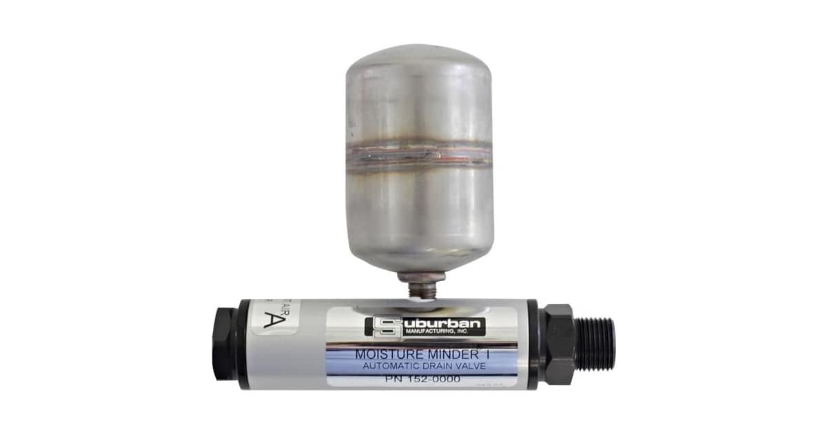

I have been thinking on the Tsunami Moisture Minder Automatic Piston Air Tank Drain w/ External Reservoir (250 PSI). No power required.

Have this 230v valve on my compressor, connected to the motor lead side of the starter so it only activates when the motor runs. It's set to the lowest setting and will bleed off 3-4 times on each compressor cycle.
