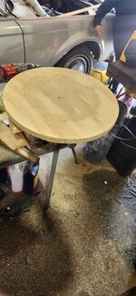

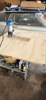

I am finishing up my stool now of a totally different design so I will start a thread.
I wanted to chime in on cutting the seat. I used 3/4 ply wood on mine and rigged up a tool out of some crappy paneling to cut it perfectly round with my router. Here are some pictures of how I did it. I was able to cut it in 3 passes with this small router.
That would be a species of the genus of Trammels.
Biggest I ever made was 23' for cutting the "wild" edges of a 40' dia. yurt platform with a Skilsaw.

Got notification of this thread being liked :ROFLMAO:
Thought I could add the second stool I made for a repeat customer!
Since I don't have a means of rolling tube, as discussed earlier in the thread, I opted to make my own brace to provide additional strength to the legs and prevent any lateral movement (in the worst case scenario).
With that said, the stool got picked up last week and last I heard is that the whole assembly is being powder coated.
Leather was ordered, and the customer will have their family member do the upholstery.
Hoping to post pics once it's done!
