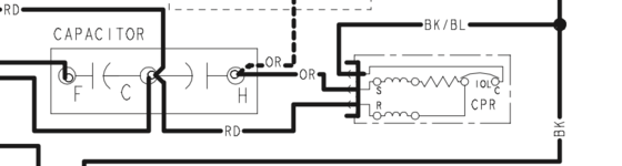

Symptoms were AC blowing without cooling and compressor not running, with a failed cap (I measured like 1 mfd on the cap and like 38 on the spare replacement I had on hand. After replacing the cap I got about 3 hours of normal cooling and then the system dropped back offline. So I called the original installer out. The diagnostic said:
"No AC Arrived on Site. System Short cycling. EEV board error code #2 EEV control board internal failure. System pulling into vacuum while Running cutting off on low pressure need to replace EEV control board & Compressor"
This is my written diagnostic, verbatim.
That said, what the """"tech"""" actually said to me was that the board controlling the reversing valve was bad which caused the compressor to fry itself.
So a couple thoughts; first off, my understanding is that "EEV" basically means txv controller which is a very different thing than a reversing valve. Maybe the board does double duty? idk. Again I understand the thermodynamic principles here but what I don't understand fully is the circuit design of a Trane heat pump.
Second, I would expect a "high end" heat pump system to detect a compressor fault and shut down, not just burn itself up. In fact, that to me is what short cycling means. I would ALSO expect that if the reversing valve is stuck or not moving properly, then you're more likely to get hot and cold in the wrong place, which shouldn't be fatal in itself. I quizzed him about this and he was completely unable to explain himself.
So my conclusion is; 50/50 he was telling the truth. If so, they probably botched the install. If not, welp.

Okay, looking for those..
Okay, I see S and R going into the compressor (CPR), and then 'C' over on the right side. I'm guessing those are it.
So, test resistance between
Black/Blue (C) <--> Orange (S)
Black/Blue (C) <--> Red (R)
then
Red (R) <--> Orange (S)
According to the flowchart. Do I have that about right?
