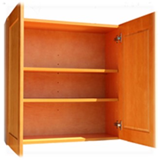

I would recommend you choose what cabinet TYPE you want, whether it be face frame or frameless.
Frameless will look like this:
Face frame will look like this (face frame left, frameless right):
Most kitchen cabinets are face frame. A face frame, in my opinion, will be sturdier since you have the frame around the doors to add ridigity. On a frameless, you don't have this and the front tends to be a bit more rickety on large cabinets. The frameless does maximize the opening for large items, as you don't have the frame in the way on the top and sides. In terms of ease of construction, the frameless is easier as it involves less pieces and is one of the reason why it was invented (for cheap mass production).
