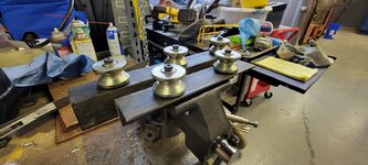

I'm installing 1" Pex-AL for my shop air system. Stuff is a pain to get straight so I made a tubing straightener. You can buy some similar tools but often they are too small and expensive. This design is pretty simple, and inexpensive. Other than the vise I'm all in at about $35-$40.
The picture show all items necessary.
-Washers to fit above and below v caster wheel
-Shoulder bolts to fit in V caster wheel
-V caster rollers w/ bearings
-Angle iron
-a vise to mount it to
I suppose you could use this for copper as well.
Oh, and it works as good as I had hoped. Very easy to pull through

Yes this has been done before. It's a good idea too!
Here is my home made pipe straightener. I ended up selling it after my install which was a mistake as I have now moved and am setting up another 3/4" Rapidair system.

What's the smallest tubing do you think it will work on? I plan on using Nickle Copper tubing for fuel and brake lines on my old truck.
Brake line is quite a bit smaller. If you offset the rollers so that they would interweave when closed then you could go as small as you would like. But they do make nylon rollers that you can use by hand for brake lines.

For a straightening enough tubing to replace the lines on one vehicle, you can drill a hole 1/64 larger than the tube thru the width of a 2x4, wipe the tubing with a bit of oil, and with the wood held in a vise just pull the tubing thru the hole. CuNi tubing is soft enough that it'll remain straight after pulling. To get a good grip on the end of the tube, just clamp a flaring block onto the end.

Easiest way too straighten tube is to clamp one end in a vise and pull on the other. You only want to stretch it like 2% of the overall length; just enough to get it straight. And it will be straight as an arrow when you are done... You then cut off and discard the ends you clamped.
