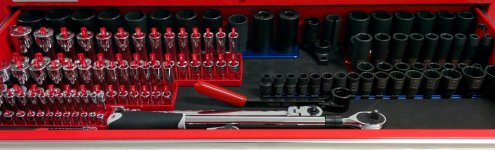

Decent example:
I just did my rear diff oil on my Tacoma (24mm hex). My long 1/2" flex head handled it well. Would I want to take a 1/2" impact to drain and fill plugs? I used a shallow socket because of the angle. A deep would have worked but would have been less pleasant.
I think starting with deep impacts then shallow then shallow 12 pt then chrome as budget allows is the way to go.
