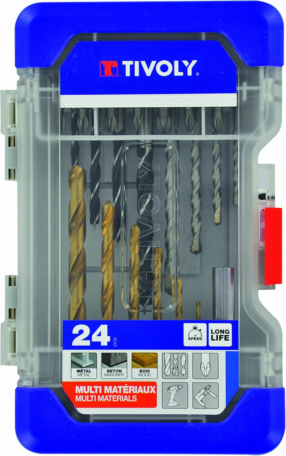

I brought a set of metric drill bits home from a trip to Europe a few years ago. I've found them useful.
A set almost like this, from the same company. The one I have has wood, metal, and masonry bits too, just a few more of them.
