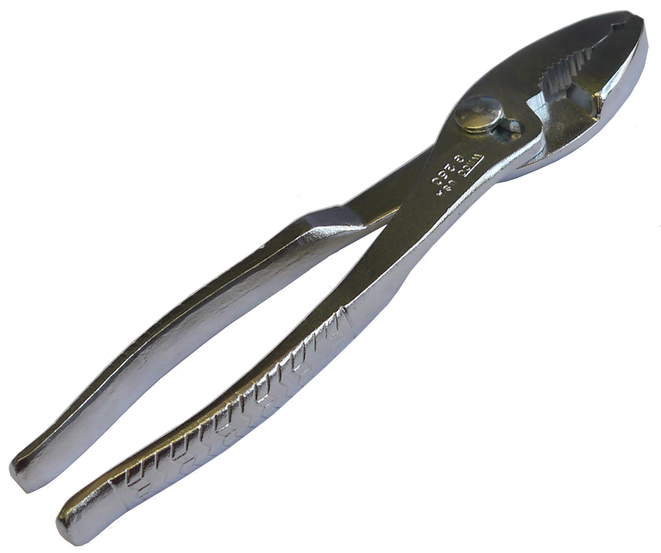

Working on a Honda motorcycle, I fought with these hose clamps the entire time. There either has to be a trick or a tool for getting these on and off. Normal pliers don't seem to work very well, the clamps just twist, and trying to work with them in a recessed area in the engine was a pain to say the least.

I'm not sure if these will work for that clamp.
They have grooves for certain clamps. I bought one a little while ago. Couldn't resist it to have just in case for $5, it's a solid quality tool, the price isn't indicative of that. Be careful if this is your first time to that site. You'll lighten your wallet for sure. ;)

They sell kits for all kinds of hose clamps. I bought one and it is quite handy.
Google hose clamp plier kit

I have always used duck bill pliers, I like my snap-on better than my channel lock ones. I grab them, pinch, then twist 90* to open them a bit more.

What about just regular needle nose pliers. A side through each hole and squeeze.

The problem with this style of clamp is that to get it to open far enough, the holes have to almost move a little past center. I've worked with them numerous times - I don't like 'em! That means just bringing the inside edges of the rings together (like you would be doing with needle nose or snap ring pliers), doesn't open the clamp far enough - hence the "twist" rd65 mentions.
I usually just end up using combination pliers, but I think the round tip opening on the Twin Grips might be useful. I'm going to try that myself next time.
