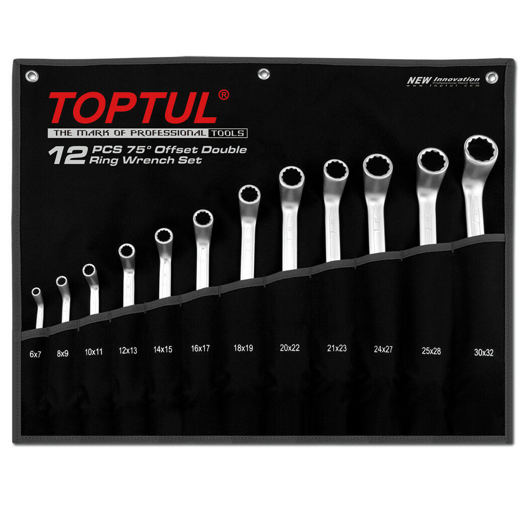

I realized everyone is talking about German tools but in my personal experience this set from toptul is without question top quality. It's 12 pieces and has the 21mm people are looking for.
I bought this in the spring, JM shipped fast and answered the one question I had.
