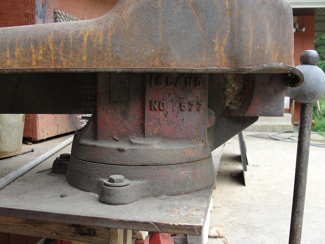

cosmo52
Jul 19, 2015
89
Alberta Canada
This ones been outside for about 30 years - I grease up the screw about every second year or so if I remember

The pics are great! I'm getting some good ideas, maybe I'll put the vise on a stand instead? Or maybe I'll put a piece of plywood between it and the bench? I also have a bench grinder I'd like to rig up some sort of way to quickly bolt to the bench when I need it. I hate grinding stuff in my garage.

Just got done pressing apart a big old Reed that was rusted solid.
Screw came right out, but had to press moveable jaw out of the body.
It’s going to live on a big outside fab table.
Plan to coat slide with spray graphite and hose it with Fluid Film.
I do like the oil pan cover idea!
drivesitfar
Oct 23, 2013
36,008
ALL: I haven't read all the posts, but I'm going to put a big Reed 4c outside and find a truck's oil pan or make a nice cover for it. then if i need to use a vise out there for something big or small I should have all the vise i'll ever need. My plan is to clean it up a bit and put BLO on it before I set it outside with it's old tire drum stand. it sat in the middle of a huge steel fab shop for years as their go to vise and other than a grinder ding on top it's in pretty decent shape.
