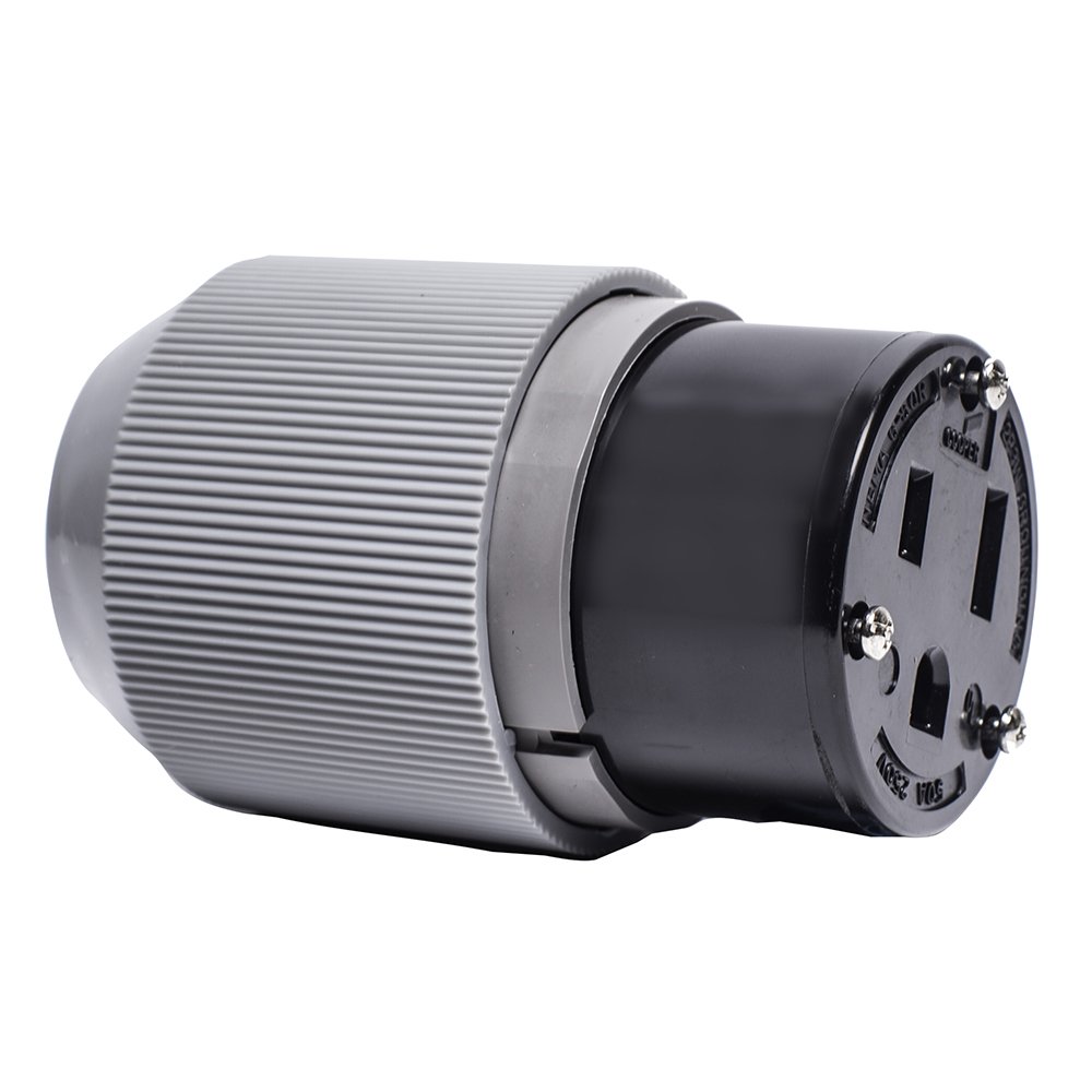

I would get something like a NEMA 6-50R molded plug on the other end... I did something similar for my miller dynasty, a 120/240 capable machine... Used L14-30 as it's standard plug then used L14-30P to 120V plug pigtail when I needed to used 120V for it....
https://www.amazon.com/dp/B00HJJ0YHO/?tag=atomicindus08-20
That is a very good choice when making up a welder cord, no jury rigged solutions then.
