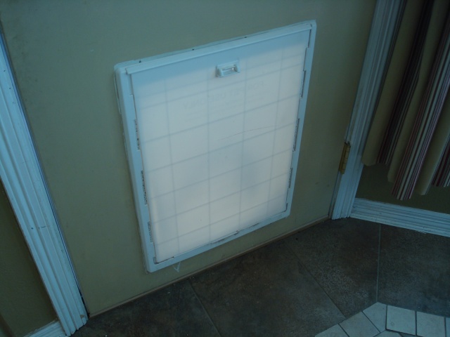

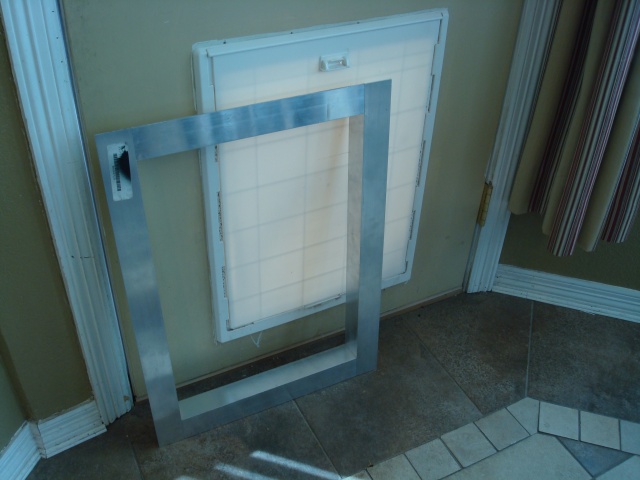

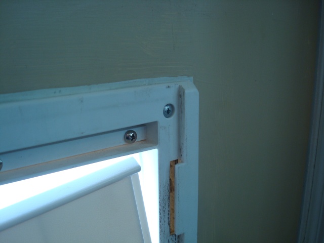

I'm not sure if everyone has a dog door or not but if you do, it's very likely you've questioned how secure it actually is.. Every time I open or close it I am reminded how big a piece of **** mine is and how easy it would be for someone to just kick it in. There are a few doors out there that are supposedly constructed out of durable and quality materials however the prices tend to be adjusted to compensate when they do. An all aluminum door, in the size I have (21 x 15 opening), will run you approximately $400. I pondered just buying one to be done with it but my wife commented "can't you build it for less?" Yes dear...damn.
The poor design is obvious from a distance but when you start looking at the doors feature up close, you begin to see just how poor the design of this door really is. For starters, other than the hardware, the constructed purely of plastic. A prybar would pop it right off. If anyone thinks that these doors provide any level of security, wrong.

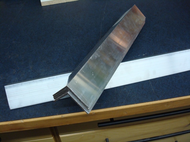

When building something, I avoid re-inventing the wheel. If all I need to do is make a few improvements to a design, that's all I'll do (unless for some reason I feel the need to way over design something for the fun of it but this is not that project). Every so often I like to put things into Google SketchUp so I can think through the design before I build it. I've been working on this idea for nearly a year now and had been stuck on a stupid design flaw that I couldn't get over until one night my wife "nudged" my creativity by asking if the dog door was ever gonna get fixed.

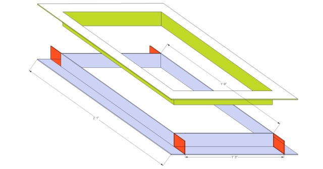

The design is simple really, instead of trying to get crazy creative, I'll make an inner and outer ring that interlock into each other through the door. The outer ring will sleeve into the inner ring (inner being the one inside). I'll use extruded aluminum angle to build the rings as show in the image above. The red colored sections is where the angle will have to be relief cut after being welded.

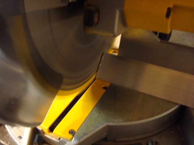

Action shot of me cutting the angle on the miter saw. The cuts are fairly square however I like to true them on the mill to make sure they are perfectly square. This helps during assembly because I can use clamps to pull the assembly square, check it with a square, and then weld. If I don't true the ends, I have to use a square to square them as I clamp them and I'm not a fan of that method.

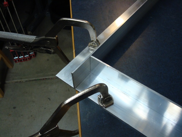

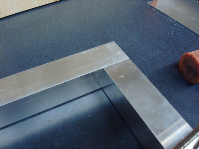

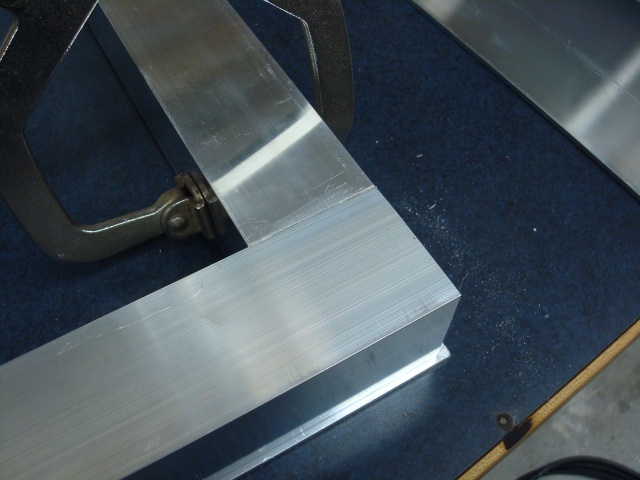

I'll start with assembling the inner ring. With the material cut and squared, I clamp it to the edge of the counter so I can visualize the assembly and then clamp the whole assembly together to see if just doing so results in 90 degree angles. Here's a picture of one of the corners. I will drop a verticle fillet weld down the inner edge here to fuse the corner then I will remove the excess (this is one of the red areas in the sketchup drawing).

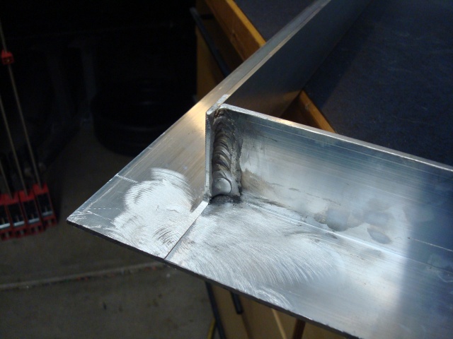

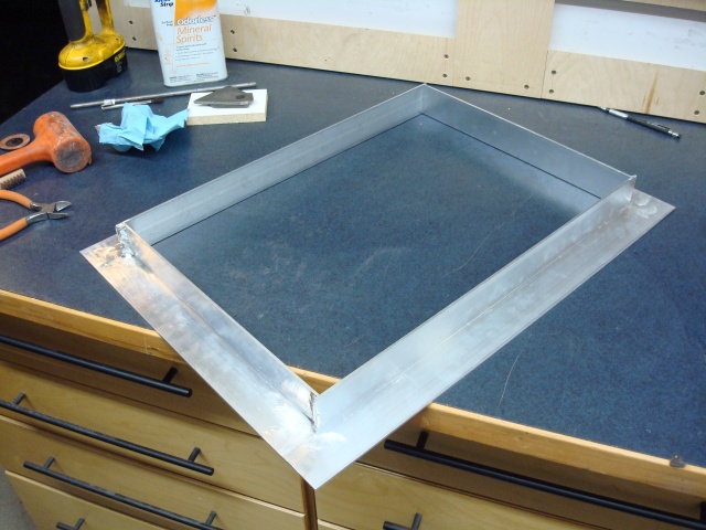

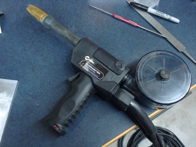

about 6 years ago now I purchased a Miller 212 AutoSet to replace my Miller 250x which had a couple hundred thousand miles on it. At the time I had a miller 3035 spool gun that I used on another one of my machines from time to time. Anyway, Miller's website had an error on it which led me to believe that i could order a 212 AS and plug my spool gun into it. As luck would have it, the 212 AS was the only machine that my gun wouldn't ever fit and to make up for their website error they sent me, free of charge, this 30A without me even asking. If I wasn't blue through and through before, I assure I was after that act of kindness. Anyway, here she is ready to throw down.
Beautiful thing about modern technology is that the manuals and pre-sets are usually fairly close. I look it up on the book (or on their moble app from the apple app store), set to the recommended settings, and hammer down. I have maybe a dozen total hours accumulated on spool guns and aluminum mig welding and, even though I have thousands of hours of regular mig welded, the equipment makes me look good. It has been about 3 years since I pulled the trigger on a spool gun. I tested a spot weld on a piece of scrap AL to make sure it was hooked up right, and then threw this down on the first try.
The only thing I don't like about AL welding is that it's fairly difficult to get all of the parts to align up to get a soot-free (no black) weld. I get plenty good penetration but it always leaves a little black. Since you have to push, use argon that hasn't "spoiled", use contaminate free filler, clean the material to get the contaminates off the surface, and fly as you keep your position, it's really easy to fall short in one of those places and get the black soot. As long as I get a good weld I guess. After cutting the corners out I sand them smooth with a small angle grinder and some scotch pads. The measurements are good and it lays nice and flat on the table.
Now that it's fully welded, I see that the 1/8-inch angle is going to be much stronger than I thought it was...probably 1000 times stronger than the plastic **** it will replace. The size measures out correctly - exactly the same size as the previous door.

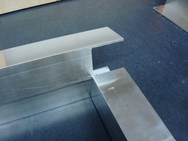

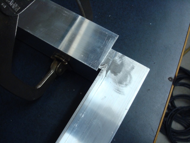

With the inner ring assembled, it's time to start on the outer ring. This one is a little more complicated and needs to fit inside the inner ring (this prevents there from being a seem to the outside of the house). To get the spacing right, on one top and bottom I insert a piece of 16ga steel to 'shim' it out so that once it's welded and I remove the shim, it will have half of that all the way around and should go together easily. The top and bottom piece need to have just a hair over 1/8-inch clearance on both sides. Something like this.

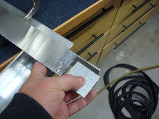

When I assembled the inner ring, I was careful to make sure all of the pieces were the same length and that it was assembled square. Now is where that time investment pays dividends. Since I need to make the outer ring about .060 smaller in both length and width, I need to be fairly careful when cutting the pieces. I start by cutting the upper and lower piece and leave 1/8-inch so I can square both ends on the mill. I keep the two pieces together so that if I do take a tad bit too much off, they're still usable.

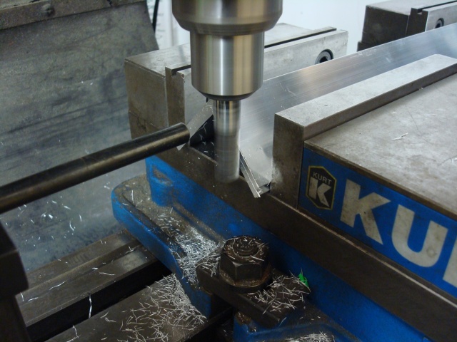

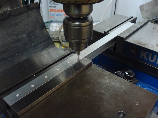

This is where a 3 axis CNC shines. I'm able to use a short end mill and program the Z-axis to move from low to high and then back to low again and I can square up the entire end in a single pop. I grab both sides and trim them to fit on the mill as well. Back to the bench with all four pieces.

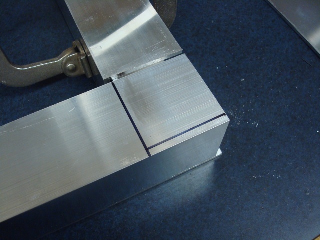

Now to mark where I need to relief cut the angle. Because I got the lengths correct I know that (using 2-inch x .125 angle) that I should need a relief that's only 1 7/8-inch wide. I mark where I think it should be and test fit to see if it's correct and it is.
Now I mark a line that's just a hair over .125 of the base of the angle and the square I need to remove is revealed.
A quick check to make sure that all of the lines are marked up. Keep in mind that right now I still have the 16ga steel spacers on one end of the ring for spacing. I use my jig-saw with a metal cutting blade in it instead because it cuts extremely quickly and I have all the control I need. I'm OCD so I'll square things with the mill after I'm done but I could have just left the edge and hit it with a flapper disc because it won't be visible.

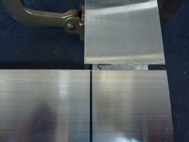

After cutting all four ends and squaring them on the mill, I test fit them to see if additional trimming is needed.
I took another skim cut off of one of them but otherwise, perfect.

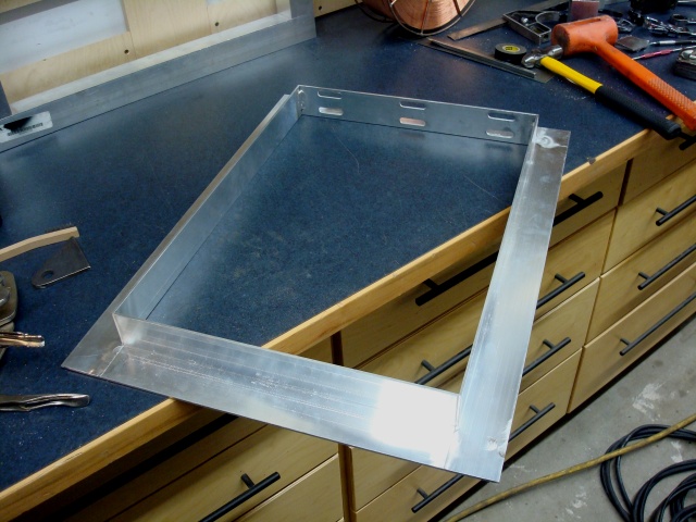

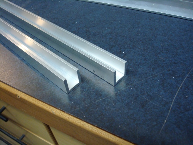

Now I need to make some mounts for the plastic flaps. The current door has a single flap that, over time, has warped more than just a little. Even when it was new there was a decent sized gap on either side. Since I'm going to the effort to make a door I figured I might as well address this issue in my design. I'm going to use a double flap front and rear and many little flaps between the two - kinda like you see in manufacturing warehouses between rooms. Since it gets fairly cold here in the winter (not as cold as some places though) I decide to use u-channel instead of angle so I can have additional internal mounting points for thicker foam on cold months.

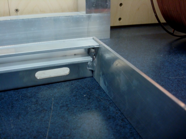

To add a little more structural integrity to the door I decided to weld the attachments to the upper frame. I don't want the welds to be visible so I want to do them from the inside. I machine some grooves in the top piece so I can weld the u-channel from the inside.
With the slots complete, I clamp it in place to get a final glance and test fit before I weld it all home.
Just as I did with the inner ring, I square it up using my true edges as guides and a large clamp to put enough tension on it so that things stay where I put them. I clamp it to the bench and clamp a small piece of 1/4-inch plate to the bottom of the seem so I know it's perfectly flat on the face where the two pieces join and, after pre-heating, weld it home. I repeat this on all four sides.

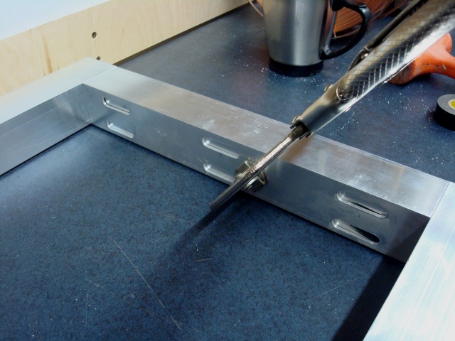

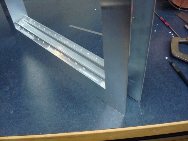

It lays nice and flat on the bench so it didn't pull at all when I welded it. I did not weld the outside ring from edge to edge like I did the inner ring. Instead I started just over a 1/4-inch in and stopped about a 1/4-inch short. The reason for this is I wanted to hide the weld behind the u-channel I'm attaching for the flaps for no reason other than it looks better and they'll be easier to fit perfectly. I only had to knock about 5/16-inch off to create a clearance for the weld. The test fit reveals about a 1/4-inch lip where the plastic and the stainless trim piece will sit.

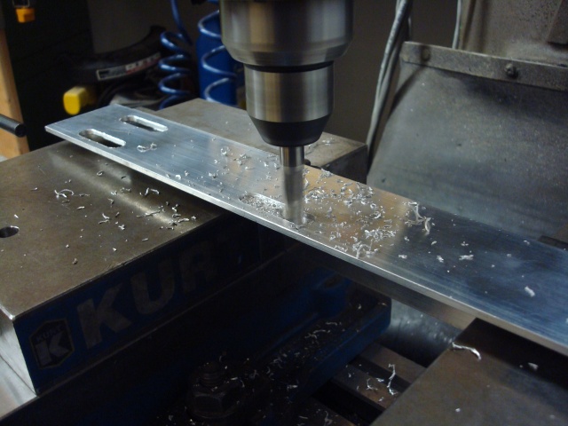

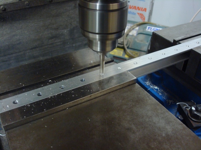

Now I need to drill the flap attachment points into the u-channel before I weld it into place. I do the math and can get away with holes drilled on 1-inch centers if I start in from one end 11/16.
I drill them about .020 larger than 7/16-inch (my chosen fastener size) so that the fasteners have a little wiggle room. Set the tooling height and re-run the program.
I've made good progress today and have worked out the few remaining design issues I had. For the first time I slide the inner and outer ring together to see how the line up. The gap is only slightly larger than the math said it would be. All I needed it to do was easily slide together and apart and it'll do. I drop the to top rails in place to see how they fit. With a 1/4-inch gap between the two, there's a perfect lip on the front for the flaps and just enough of a spacing on the inside for the fasteners to clear the slide-in door.

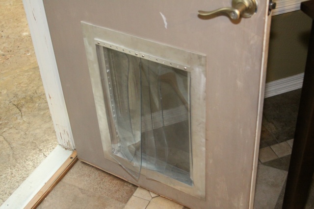

I ordered 2 flaps used for industrial flap doors (maybe 8' long each) and cut them into smaller pieces just long enough to make it from top to bottom and made some sandwich strips out of aluminum to allow a couple of screws to do the work all the way acrosse
The idea was to be able to have more rows of them in the winter and less in the summer to aid in keeping out the cold air (or keeping the cold air in) and help prevent stray flys and other bugs from lucking their way in. I also added the U-rail that the door itself slides in. It's 3/4-inch x 3/8-inch u channel. I had to machine some access grooves to give tool access to the fasteners.
It's a little more obvious in the outside view. I added two more channels on the sides of the door so I could have side mounted flaps. One thing I noticed in the previous door is that the single plastic door allowed a lot of air in on the sides and, ironically, the dogs also always had snow on their back when they entered - except in the middle where the door would touch. I figured that with the side wipers it they'd eliminate the draft and help remove the snow from the dogs (better anyway).
Since the above picture was taken I've removed the third (outer) set of flaps. The dogs could manage their way through them but because they weren't used to the setup yet, they'd wait until the last minute to go out (which would result in them pacing around a little). It's been about a month now and using the door has become an easy affair so there's no reason why the third set can't go back up as soon as the temp drops.
Total cost? Probably about $300, same as the ones I was looking at on line. The difference comes in with the replacement flaps. The on-line versions had replacement flaps starting at $80. I have about 3 sets of replacements stacked up in a drawer in the shop already and I can make as many as I want for a fraction of what a new one would cost from the other guys. All in all, I'm pleased at the results.
