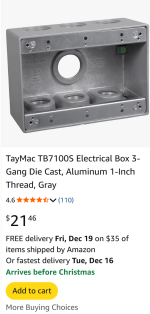

I had found this on Amazon, but have my doubts it's Garvin:
But never found a cover...

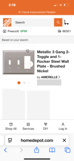

That's a three gang handy box; there isn't a cover, it would be a three gang plate. There might be a three gang handy box plate available which wouldn't look too bad, but a regular three gang plat would look awful since it's going to be taller and wider than the box.

You did state you couldn't find a cover. There is a difference between covers and plates.
This configuration might not be too bad, at least it would be something meant for surface mounting.
Edit: wrong cover. This one and use decora switches.
