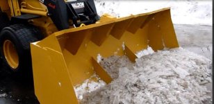

Today I headed out to the workshop to build some extensions for my snowblade for my mini 4x4 tractor. I started with sheet metal cutting it into 6 inch strips with the nibbler, then trimmed up the rough cut edge on the knotcher . Then I cut the pieces to length . Next I marked the curve and cut it with the nibbler on the first two pieces. After drilling the mounting holes I began welding all the pieces together . I am adding 5 inches to each end of the blade so when it is plowing snow at full angle it pushes the snow out past the duel wheels.
