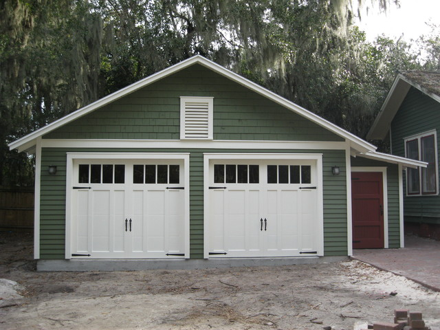

The only problem with the shop (besides being very basic) is the doors. It appears to have had double barn doors on the garage at one point with the opening framed out with the 8x8 beams. They must have been in dire need of repair at some point and some silly person stuck a track and a sliding aluminum door across the front that looks like was a gate or maybe a piece of aluminum roofing. Very trashy looking and it's the first thing i see every time I go there. So I'm going to make some new doors.
I'm going to go with double swing barn type doors, and there is a detail in the doorway I want to enhance. The upper corners of the door opening framed in at a bevel of about 30-45 degrees (making the top 10 inches of the doorway more narrow). I want to keep that feature and put a row of small windows on the top row (sort of a craftsman period touch) and I'm looking for samples and suggestions. Especially if any one has one with the beveled corners.
Sort of like these:
le
http://st.hzcdn.com/simgs/47f139fd0f86098d_4-7085/craftsman-garage.jpg
(but there is only one opening)
I want to keep the window height small. Both for security reasons and to work with the height of the beveled corners, so a single row is a better fit.
I'm also looking for hing and latch latch hardware ideas. I want to keep it close to a craftsman or bungalow period look (the house has elements of both) and I lean more towards the craftsman style. But I am going to frame the doors in aluminum (probably 1/8 1x4 rectangle tube I'll weld myself ) and hang the door surface on the AL frame (which I'll paint to match so I don't loose it's great classic shop feel :)
Thoughts, sample ideas, pics, and hardware suggestions are appreciated.

Here are a couple doors.
The red is about the color of the building.
The green one show a rough approximation of the structure I'll use (though my dimensions will be different). A square frame with single diagonal for the main door area and an upper section for the windows. My doors will be wider and the window area smaller.

As you probably know, two biggest issues are creating hinges that can sustain the moment-arm of the door and stay parallel, plus sealing the doorway opening. The hinges I typically see have a giant strap length on the moving part but a very short bolt spacing on the stationary part.

I have a name for the kind of hinges that work well. Big Strong *** Hinges ....lol
I do have an 8x8 post to attach to, but instead of sinking big bolts into it, I might weld the hinges to a corner bracket of some kind and have it run the height of the door with multiple screws or some such idea after I think about it a while :)
I'm thinking maybe an old industrial looking hinge, so i could use a weldable barrel hinge attached to any arm I like. Trying to find the perfect hinge pre made for the right size and load is like asking to be frustrated or pay a ridiculous price for some thing a guy made just the way i would ha ha.
This is exactly what troubles me with the barn doors and makes me think more towards an overhead sectional garage door. I can see sealing the sides and top with weatherstrip to the jamb, use an astragal to seal the doors to each other, but what about the bottom? I don't want to create a lip on the concrete for the door to seal to. Also, locking the doors to each other doesn't seem very secure, but I guess a cane bolt lock would work for one panel with the receiver cast into the concrete floor.
