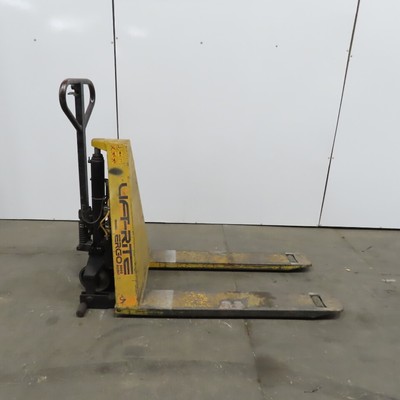

Not sure if you want to spend a few bucks but look for a battery pallet jack used, great for moving lots of stuff. We use one to move cars in the city, also get a pair of skates makes it real easy. Just watch mb, ebay, cl, auction sites they pop up quitea bit.
