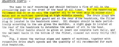

We're gonna drain, fill with diesel, run for a few minutes, then drain and fill with oil.
-Let it drain for a while, 'couple of days, if you can. Make sure you get as much diesel out before refilling as you can. And you're putting in freshoil, right?
Dad is wanting to use some 303 we have on hand just "for a short while", but after reading about it, I'm a bit concerned.
-What's "303"?
And you don't have to worry too hard about getting it "squeaky clean" in there- you mainly just want to flush out any contaminants, like dirt, rust or moisture. The diesel flush should do that just fine, but as you said, I sure wouldn't run it very long like that.
Refill with fresh oil and call it good.

Yellow bucket hydraulic fluids. If we don't leave it too long, it will help as an additional flush.

-Curious why you didn't go with an ISO 68.... 30 Weight is about ISO 100, as opposed to ISO 68. That's going to be a little thick, I think- I don't know what, if any, real difference it'd make,
I doubt the 30W will really hurt anything, but for a marginal difference in cost, I'd rather play it safe than sorry. :D
A-ha! Doc, you've been absolutely right about most things I've seen you post, but I've got you here. We are going with the 30 weight because both the book and tag expressly tell you to use S.A.E. 30 weight unless you live in a cold climate and/or(depending on how you interpret their wording) are running higher spindle speeds, then S.A.E. 20. That and non-detergent 30 weight as specked is $40 for 5 gallons. I'm sure the oil will be as good if not better than what they had in the 40s, and it was probably running 24/7 in the 40s. I think we'll be ok.
but I know for a fact I absolutely do not want to have to take my headstock completely apart in order to replace some massive and fabulously expensive bearings.
I priced them because I was curious. All the intermediate shafts use common, metric double row angular contact bearings. The main spindle bearing can be had for around about $100. https://www.ebay.com/itm/TIMKEN-BEA...332408&hash=item2a81dcf970:g:rzcAAOSwX9FZEf-B

A-ha! Doc, you've been absolutely right about most things I've seen you post, but I've got you here. We are going with the 30 weight because both the book and tag expressly tell you to use S.A.E. 30 weight unless you live in a cold climate[.]
-As with all of us, I only know what I've read. :D "ISO 68" is basically the reflexive response when anyone on PM asks what oil they need- if you don't know the exact specs of what you need, it's a very good default choice, and it IS what a large number of manufacturers generally recommend.
The only cases that I can think of off the top of my head, where you need something else, were the old Lodge & Shipley "Servo Shift" machines, which used an actual hydraulic mechanism, kind of like an automatic transmission, to shift gears, and anything that had a "wet" clutch- one that was mounted inside the gearbox with the rest of the goodies.
I learn stuff too, in these threads. :D

Just a thought about gear lube. I've been working with an offshore boat powered with a 1500 hp helicopter gas turbine engine. The gearbox was made by the same shop that makes gearboxes for the unlimited hydroplanes, and their spec for gear oil is the ISO 68 EP gear lube. It's crystal clear and is even authorized for use in food machinery. The gearbox uses a dry-sump oil system with an oil cooler.
Be careful to get the EP stuff. I once had them try to give me the ISO 68 hydraulic oil instead.

Where does one get this ISO68 oil? I saw TSC has ISO68, but it is labeled as hydraulic fluid. I'm sure it does not have the EP additives.
Provincial
Sep 21, 2011
6,872
Near Salem, OR
J20 rated Tractor Hydraulic Fluid is sort of a multi-grade oil, with a viscosity rating similar to ISO68 when hot, and ISO32 when cold. Both 33 and J20 Tractor Hydraulic Fluids (when of good quality) have Extreme Pressure ratings for use lubricating heavily-loaded reduction gearing in tractors and other equipment, as well as wet clutches and brakes.
Remember that hydraulic systems include highly-loaded pumps and their associated gear reduction systems, so the fluid has to have serious anti-wear properties.
ttpete
Mar 8, 2011
6,737
Dearborn, MI
I had to get mine from an industrial petroleum outfit. They filled a 5 gallon pail from a storage tank. It was clearly labeled EP.
