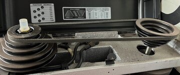

I keep my belts on pulleys for the slowest speed, always use 90 weight for cutting oil. I’m not doing any production, so slow is good. Always clamp the work or use a vise. Do some study if drilling stainless, HSLA, etc.

About thirty years ago, I bought six drill bit sets from Canadaian Tire on sale. Have drilled everything, even spring leaves with them. The secret? Drill slowly, keep constant pressure on the bit and keep the bit flooded in oil. Drill through a washer hole to keep the oil plentiful and corralled. I usually use cutting oil, but have also had good luck with using old motor oil in the past. My drill press also never leaves the slowest speed.

That's all I use them on, wood or plastic.
Now you know. When you said 3000 rpm, I thought no way it was single speed unless it was ungodly old.
I'd also suggest, if you don't do it already, is cut yourself some pieces of OSB or plywood to put on the table to save the drill bit when you run through the material you are drilling.
