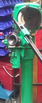

I always like to have new tools. I wanted to learn how to sharpen drill bits better. I had been watching for a high quality bit grinder for a very long time. I found this STERLING with Google search, over 6 years ago. SAVONA Equipment had this one for sale. They were not "giving it away" but I could not pass on it. I made the guard and installed the electric box. The mobile base makes moving this heavy machine easy.
If a person is serious about quality drill bit sharpening, another good brand is the Lisle 91000. I would buy a Lisle in an instant, if one was offered for sale, here.
