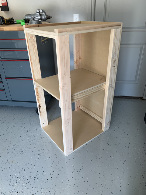

So, I'm thinking of getting into some smaller wood working projects and wanted to get a small drill press and belt sander but don't really have a fixed place to put it...
Have any of you found a good way to use these tools without them being out all the time?
I've got a small workbench I could put them on when working on a project or I was thinking of building a collapsable table to use during projects...
Anyone have this same issue or have any thoughts?

W
wkndwar
Apr 18, 2017
19
Oklahoma City, Oklahoma
W
wkndwar
Apr 18, 2017
19

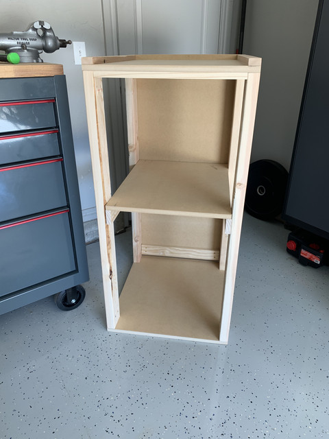

So here is what I put together this morning with the link from above, although I haven't decided what I'm going to do for the sides and the door yet. Casters are on order from amazon.
I made the shelves the same size as the cut out on top so I can mount the tools on the shelves and slide them into the base on top when needed.
