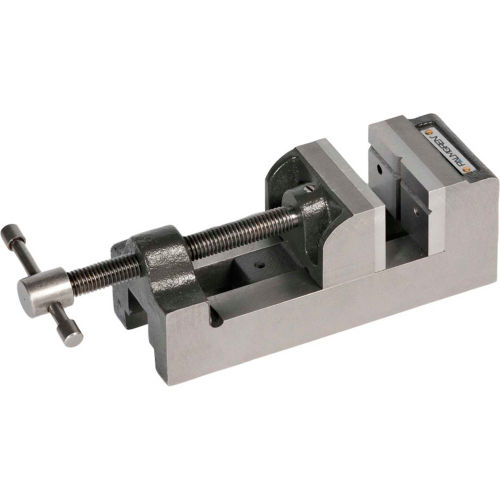

It really depends on your projects. For me, this is what I always have at the DP since you can use it on 5 of it's 6 sides. Don't even think of getting one without the two V grooves in the stationary jaw.:
One of these might be better if you anticipate a lot of clamping of work to your DP table but you sacrifice versatility.
I have a crossfeed vise but rarely use it. I've also rarely use a DP angle vise.

For that drill press, a vise like the first one dave posted, a fence and a few good sized c or f clamps should do all you need.
Putting a float lock style safety vise on that small of a drill press will be a royal pain (in my opinion).

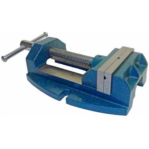

My most used DP vise is a HF type mounted on a track. Easy on, easy off ....never an excuse for accident prone hand holding stuff.
Believe yours also has a rectangular table.

Those type of vises take up a lot of vertical height on a bench top press which has limited headroom as it is. I can set up my float lock quicker than I could clamp something in one of the screw type vices. I would personally use a clamp vise before I use the screw type drill vise. Unless I needed parallels or a v block.

Delta Homecraft 11" drill presses are impressively heavy for their size, but the table is not too large. I would get a 3" Palmgren like Davefr showed in the post above.
