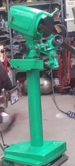

After what seemed like a long time searching for a STERLING drill bit grinder, I found what I was looking for. The grinder was in some almost forgotten inventory of a used machinery dealer about 367 kilometers from my shop. I went for a look and we made a deal. The drill-bit grinder has suffered a little from decades of reasonably dry storage. Before I can use this machine, it will need a complete service and freshening. This has turned into a full restoration plan. I called the OEM and all of the parts are available at very reasonable prices.
I should mention the pictures are what the restored grinder will look like. Other than a coating of heavy dust and a little surface rust, the grinder I bought looks the same.

After looking at my new to me grinder for a week, I took it apart and, started the metal cleaning. Today, I got the base and the motor house painted. This colour is very close to the original STERLING color for this model year.
I am pleased to report that I will need to replace two inexpensive pieces. I could probably reuse the 59* bit stop, but I think it may have been bent. There is a protective boot missing from one of the adjustable shafts.

I contacted the Sterling factory and ordered four parts for three missing and one damage original pieces.
The serial number on this grinder says it was made in June of 1968.
There is no measurable wear on any of the control surfaces. I had to use a mill file to remove a few hammer marks on the drill carriage. The minor surface rusting was removed in a few minutes with EVAPORUST in a 30 liter ultrasonic parts cleaning tank.
Rather than polishing and or plating the adjustable knobs and levers, they were cleaned then treated with BIRCHWOOD CASEY metal super blue.
Today I hope to build a mobile transport base for this 380 pound machine.

more pictures. I used the pictured roller to transfer paint to the raised lettering. After spraying red into the STERLING on the motor housing, I used this soft roller to apply the dark green cover paint coat.
I made the safety cover for the grinder stone.

Finally, the mobile base for this grinder is finished and installed under the machine. It works perfectly and I think it looks really good.
