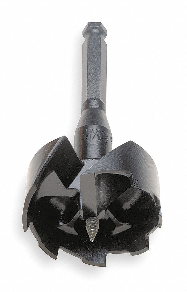

so now that the panel is in and hot in the garage, time to install circuits... How would you drill the top plate over the panel? I'm thinking one of 2 ways... either drill a couple 1-3/4" or 2" holes with a hole saw and run all wire thru that, or use a 1" auger and make swiss cheese of the top plate...I'd like to drill a bunch now so I dont need to worry about hitting wires down the road if I run more.
The truss load is perfectly stacked above the stud right there...so thats not too much of a concern... but by the same token, i dont want to go overboard and remove the entire top plate...

Plumbers self feed bit in 2" works well. IF you have a drill that will handle it.

If you end up with less than the required 1 1/4" thickness from the hole edge to the edge of the stud after you drill your hole(s) you will need to put in wire protection steel plates.

These tools aren't enough for that. The self-feeders, especially 2 inch, require a very slow and powerful drill. My Milwaukee right angle even struggles a bit under load and it is geared to 350 rpm as I recall. Hole saws ****.
The M18 won't do it and the holeshooter would be dangerous. You need a real right angle drill that you can hang onto or at least be extremely careful with the regular holeshooter.
Anyway, I would drill a series of 7/8 holes through the top plate. Drill as many holes as you can, you can fill the unused later with fire caulk.

What are you calling "self-feeds"?
This is what I call self-feeds
3XU97_AS01
2" is a lot different from 1.5". Using a battery drill on larger self-feeders is a great way to destroy the drill.

The milwaukee big hawg bits are a great alternative to self feed bits, they are basically a hole saw with three carbide teeth, need a lot less power then a self feed and are way faster then a hole saw and last longer too.
Don't do this, you'll run into 334.80 issues.
This is the way to go!

The cables are considered bundled(derating applies) when more then 2 cables go through the same hole without spacing, when that hole is firestopped, caulked, insulated, etc.
It's easier to just drill a bunch of 7/8, 1" holes and not even worry about it.

Back to topic...I drilled about 8, 1" holes in the top plate... should be good enough for now.
