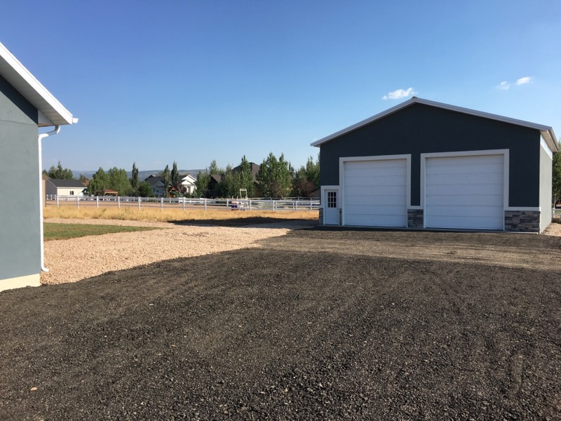

And here we are today, built and moved into. A 36'W x 40'L x 16'H big blue box of goodness. I had hoped to share this while we were building it, but life was too crazy. So I'll share the journey I've been though to catch up.

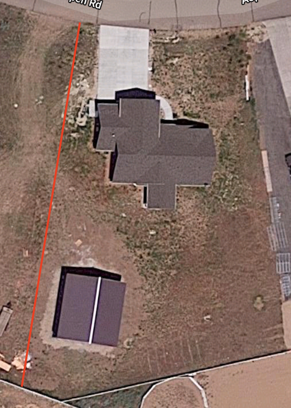

And a lot layout courtesy of Google (pre-landscaping)

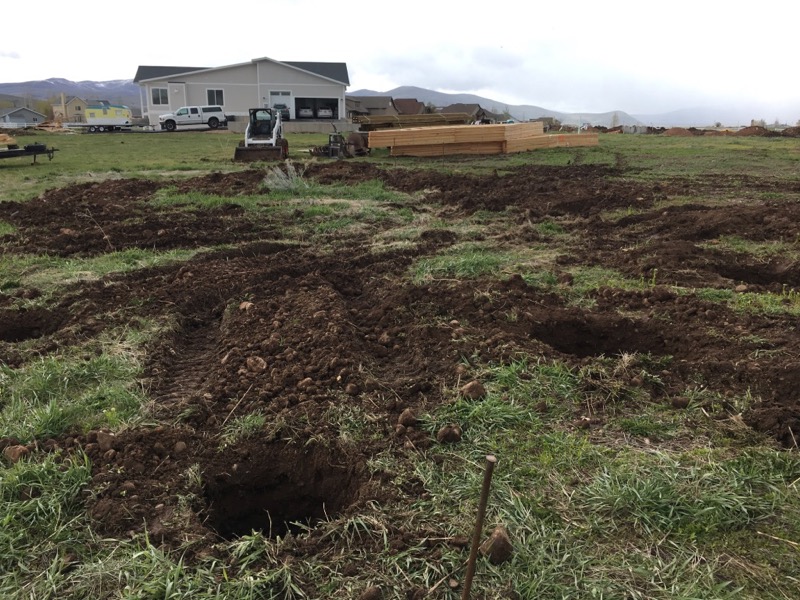

So April of 2017 the barn raising party started. Unfortunately I missed the opening weekend when they laid out the location -- unfortunate, as they put it in the wrong place! Luckily, I caught it before anything was dug into the ground and they moved the stakes to the proper spot. A bit of confusion based on our back property line was all.

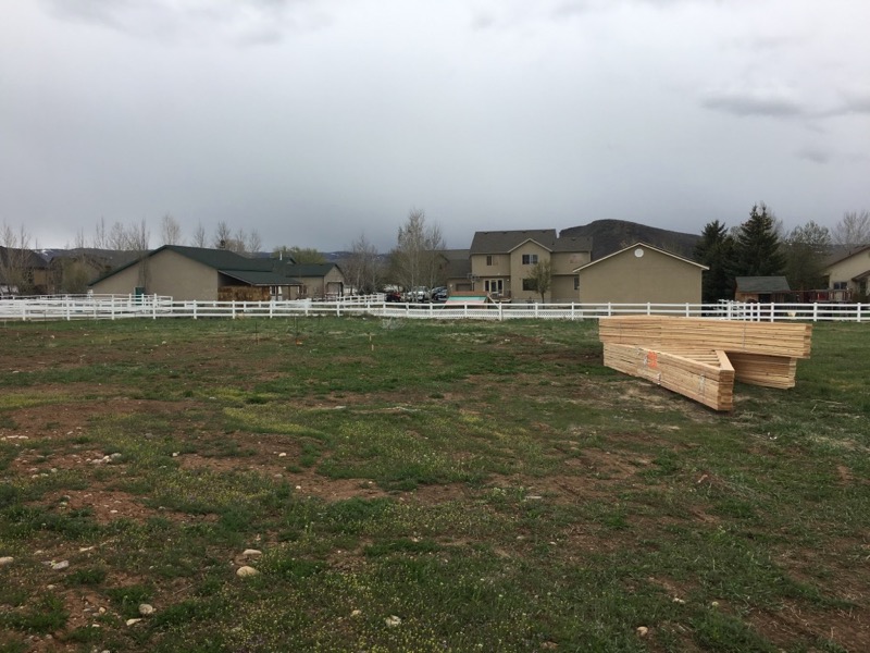

So we start with stakes in the ground and some parts in a pile. I'll admit that we used the neighboring vacant lot to good advantage. Our lot is about .7 acres, a nice size for what we wanted.

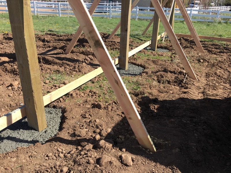

Holes dug, hope to all that is holy that they're in the right spot (they were).
Concrete in the post holes, moving right along.

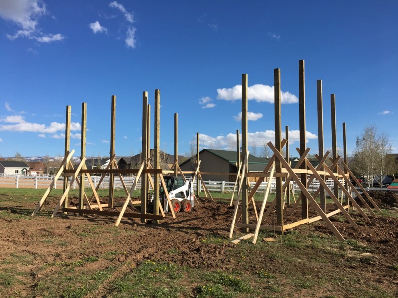

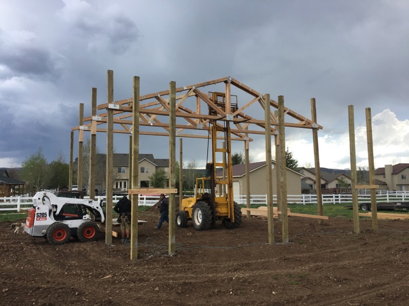

Poles up, and we start to get a feel for the size of the thing. Poles along the sides are spaced at 10', the end at 12' for a 36' by 40' footprint. A good size that made the most use of my available budget.
I left plenty of space to the inside of the property to add a lean-to for parking my trailer in the future.

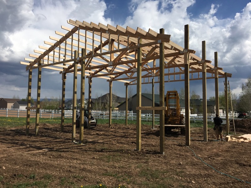

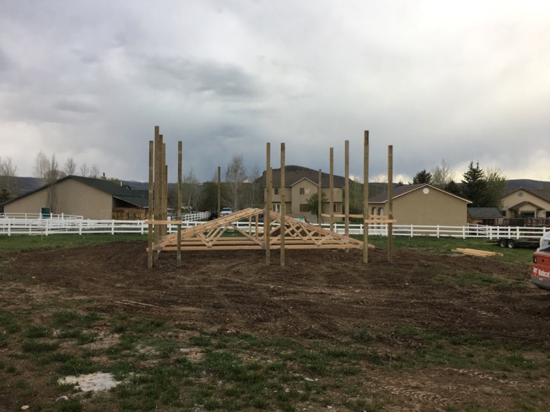

Up go the trusses

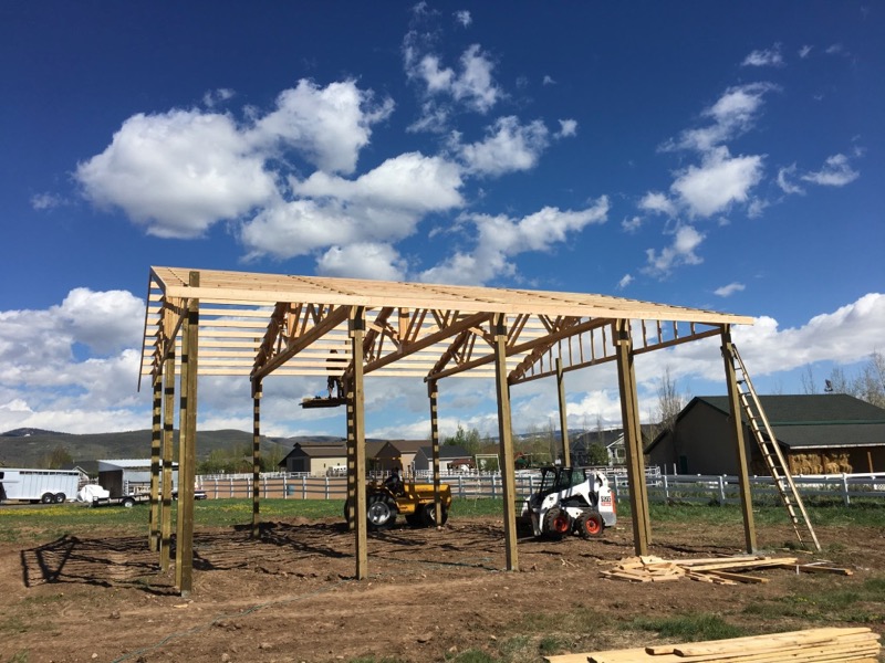

And now we move into May 2017 with the raising of the trusses. This is where the Droobarn stopped looking like a forest of poles and turned into a building-shaped object.
Here the trusses are joined together and getting ready to be lifted into place.
There were two guys (father and son, the grandfather started the company and still does the bid and design work) working on the barn. Hard workers both, just got to it. Up go the trusses
This little guy belongs to the builders -- though by now he's not even close to little! A St. Bernard puppy that romped around while the two builders worked. I made a new friend for the duration.
And now it looks like a building, at least the skeleton of one. This quite the moment for me, when I could see in reality what I had thought about for a long time.
