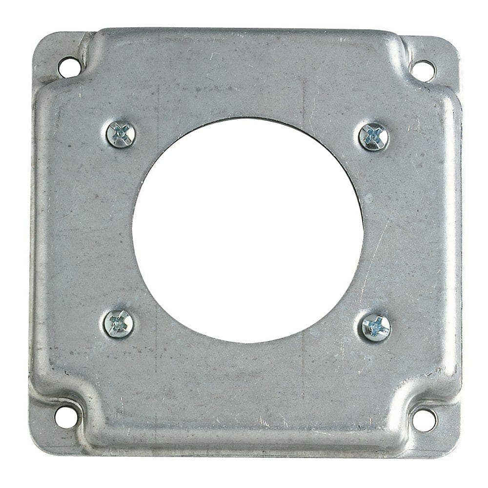

I have two welding machines on a cart. I only use one at a time. I have an extension cord for plugging the machines in. I would like to put two 6-50R receptacles on the end of the cord, I am tired of unplugging one machine to use the other. I am looking for an elegant solution to make up a good cord end. I am thinking a 3 gang box with two 6-50R receptacles in it. I have been unable to find a cover plate for the two. I can make one up, but would rather use an over the counter solution. Ideas?

2 deep 4X4 boxes nippled together w/ a 1/2" raised cover for 30/50A devices.
No need to reinvent the wheel when off the shelf will work, put a 3rd box between the two to splice the cables w/ a blank cover on it.
Over time the movement of the cable will loosen the locknuts on the sheet metal boxes.
Additionally the remaining KO's are too easily knocked in.
I'd use deep boxes with threaded hubs (like Bell boxes).

I think part of the point of this setup is to not need to plug and unplug anything at the cart
I use bonding locknuts so that doesn't happen. Can also get boxes w/o ko's.

1,075
Oregon
Probably will NOT do 120 on this cord, other end is just a single 50P. Main reason for the extra conductor is the old hotrodder adage, "run whut ya brung" :D
Can't find non-knockout boxes here, couple quick tacks with mig works.
mm08822 got the reason for 2 ******* - IME that also lessens likelihood of lock nuts loosening.
Yeah, IIRC I ran ground and the "spare" thru the second ******.
I also back up nuts with the smooth plastic nuts, less likelihood of chafing AND tends to (sorta) act as a lock nut.
I have 3 hard-wired 6-50Rs within 10-15 feet of where I do probably 95% of my welding, the 85' hangs on a garden hose hanger unless I need it for the rare exception... Steve

Surface mount receptacles are rather fragile, used one on a extension cord 40 years ago or so before I knew better, it worked great for me, but when someone else used it they dropped it rendering it into trash, even a 4X4 box fares poorly for the same reasons plus not compliant to use either one that way, it would not take much to crack them on a welding cart, a previous suggestion to use Bell boxes is good, with a chrome or stainless plate to trim it out makes it look pretty good.
