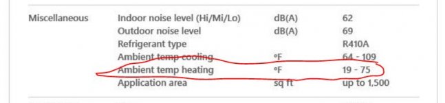

Your link to the listing had expired. If you go to the original listing there is a link to manuals--including the specs.
http://www.bonterrahomeandgarden.com/content/15 SEER Specs.pdf
It says that the ambient (outside) temperature range for heating is 19 to 75 degrees. That doesn't sound too promising for heating when the temperature is 10 degrees.
I'm not familiar with the Air-Con Inc. brand.

That link takes me to a page for an Air-Con 24,000 BTU unit. Read specs is tricky, because different manufacturers use different terminology. I this case what you should worry about is
I take that to mean below 20F you are not going to get much of ANY heat !
Get your data in writing from the manufacturer. If you can't figure it out call the company and ask them, "When in heating mode, at what temperature does your unit fall below 90% efficiency ?" For example.
