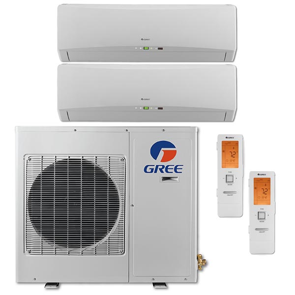

http://www.ecomfort.com/Gree-G2H30T09240000/p63300.html $3,021
This Gree unit (which many here seem to stand by from experience, although its certainly the 'more economical' option) seems to carry a seer rating of 21.0. However it calls for a 30 amp breaker.
Per the manual, the Gree Multi30HP230v1BO specs at a max amp draw of 13.9 amps which is a power consumption of 3,206 watts, when the outdoor temp is 95°f, and the indoor temp is 80°f. ( AHRI test standard)

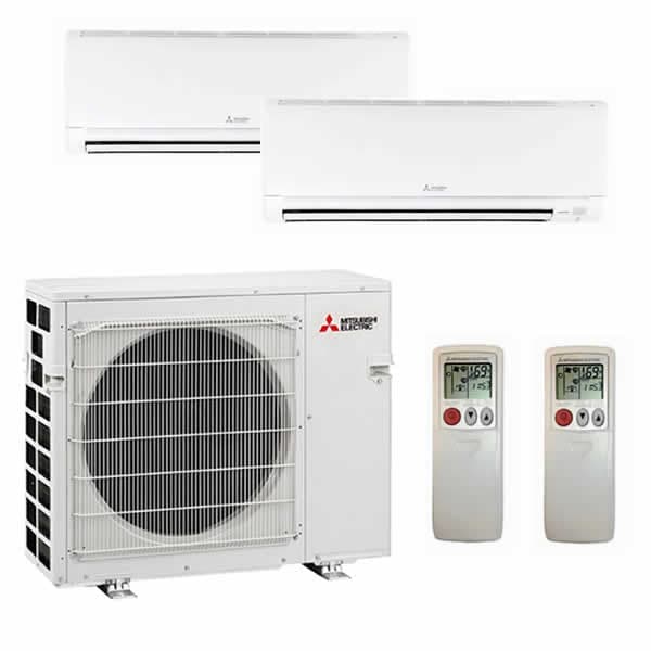

http://www.ecomfort.com/Mitsubishi-M2H30W09240000-B/p56946.html $3,646
This Mitsu unit carries a seer rating of 17.6, and calls for a 25 amp breaker.
Per the manual for the MXZ-3C30NA, the unit specs out at a max amp draw of 11.65 amps, which is a power consumption of 2,680 watts at AHRI testing temp standard again of 95°f outside, 80°f inside.
In summary, the Mitsu unit uses 526 less watts of power(2.28a) at AHRI testing standards, yet is rated at 3.4 seer LESS(supposedly less efficient) than the more affordable Gree model.

I don't know what kind of support you have from Gree in your area, but I can tell you this:
I've sold/installed dozens of Gree units like you're showing here, all troublefree.
We've had more problems with Fujitsu units, actually.
I would not hesitate one second to purchase a Gree system like you've shown.
