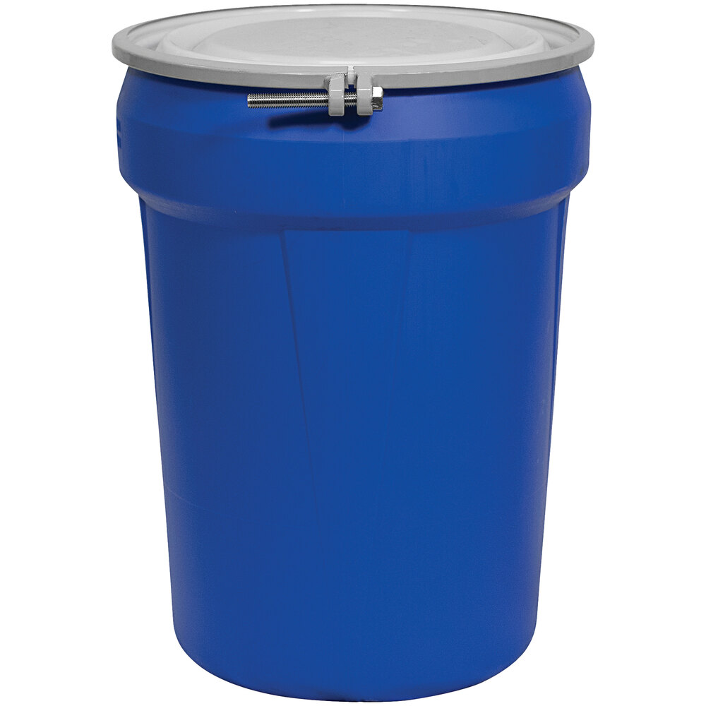

I have my metal Dust Deputy on one of these. It is very heavy HDPE and a 5 gallon plastic bucket fits inside for easy chip clean out.
