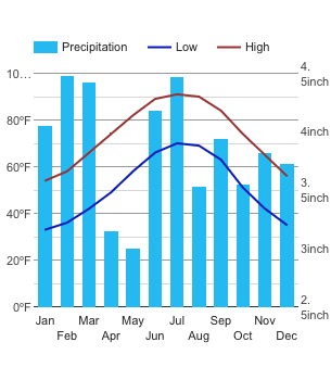

Do you live in a climate where ambient temperatures drop below freezing?
Very rarely. I live near Athens, Ga., about an hour east of Atlanta.
Our coldest month is January, with an average low of 33°F.
I would say that each year, we do have a few cold snaps where it gets down into the high teens for a few days. Wind chill can be lower. I occasionally have to cover outdoor spigots, just to be on the safe side.
