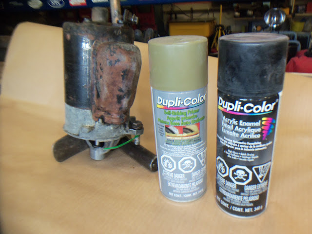

The very rusty starter motor was shot with Dupli-color's Self-Etching Primer for maximum adhesion and topped with their gloss black to ensure long-term protection and to keep it looking great under the rod for a long time to come.

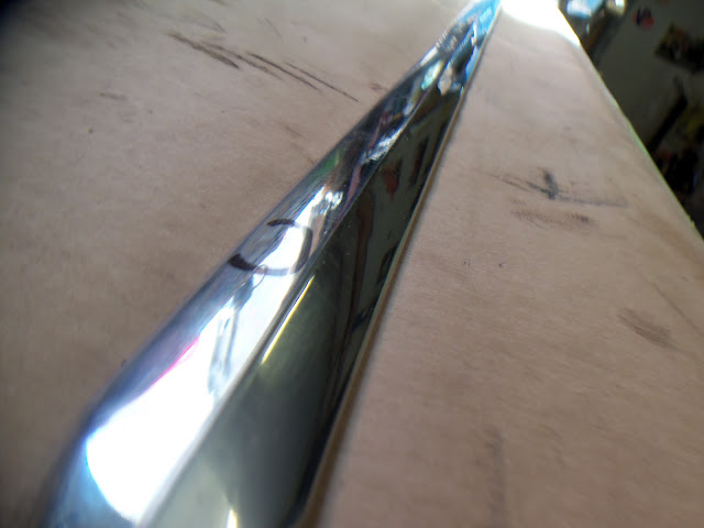

Back on the chrome trim for the 40 Ford.....
Here's a method I learned to spot dimples and get them worked out in thin chrome trim
First, mark the damaged areas with a marker -
Then, I put a layer of marker over the damaged areas -
So that by using a blade to scrape the area, I can find the low and high and spots -
Here you can see where the blade exposed a high spot, showing that it's dented from the top side -
There's lots of ways to work out the damage on thin chrome pieces - but (unlike some things we do...) the key is to not push too hard, or too fast. One tool I like to use is a piece of wood dowel chucked in the drill and using it as a press (ie. not spinning!). The dowel edge was rounded a bit prior and the wood is soft so it doesn't cause any harsh marks in the chrome as steel would.
Or, you can use different bits of wood to push and/or rub the damage out too.

Cool tips on the chrome trim, and wooden dowel. Thanks for sharing. I assume you are using the drill press like an arbor press, not with the drill/dowel spinning.
