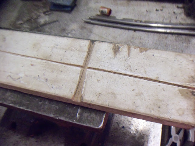

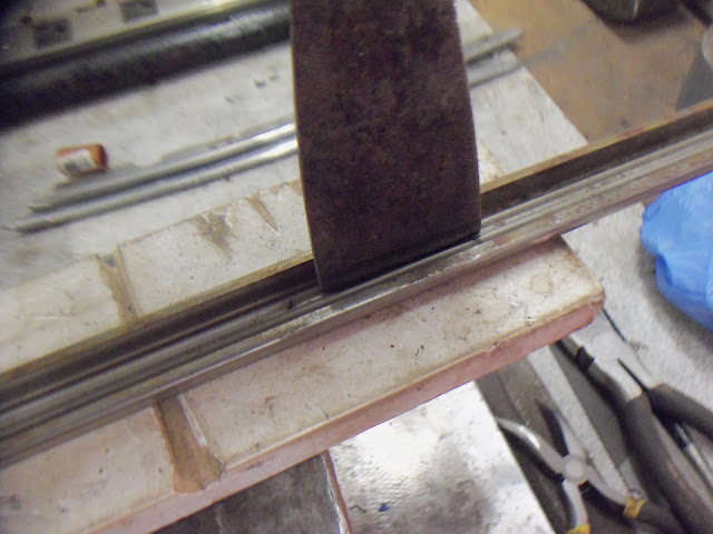

These are the original SS side mouldings for the 40Ford. Although in reasonable shape, there's lots of dents and dings that need to be worked out before polishing them.
Some of the tools of this trade -
But usually, ya just have to make what you need, as you need it, like this bevel I ground into a piece of scrap steel to back up the moulding edge -
Before -
After a bit of work -
Then lots more work...
Almost ready to polish -

E-Tek, pretty amazing how you brought that trim back to its old glory; very cool.
"But usually, ya just have to make what you need, as you need it, like this bevel I ground into a piece of scrap steel to back up the moulding edge -"

Ed, nice job on the stainless trim!
Thanks Robert - I'm sure you know the process!
nice job on the rustoration don't envy you on this one I hate rust repair ! just explaining how much work that this is going to take to anyone and seeing the look on there face is hard enough then when they say ok it gets even worse.:(
Other than the dirt, I actually enjoy doing rust-repair. I like almost everything from cutting out the "cancer", cleaning up the adjoining areas, making new peices and bringing stuff back to life. There's a lot of "thought-full fabrication" that goes into it, plus it's a skill few people have, so I can always hep someone out. I know - I'm weird.
This may be way off base for the application, but do think it would be possible to make various 'press dies' for many shapes/operations and use that brand new press to speed metal mending, or would it increase the amount of deformation/distortion/shrinking/stretching? :dunno:
As per making dies - definitely - but I think the press would be overkill for this. The key is to go slow and not over-do or stretch it, as the metal is very soft. But I have used my drill-press in that way - making a die and using it to press the piece gently. These particular pieces had very little damage and it was all channelled, so much of the process went like this:

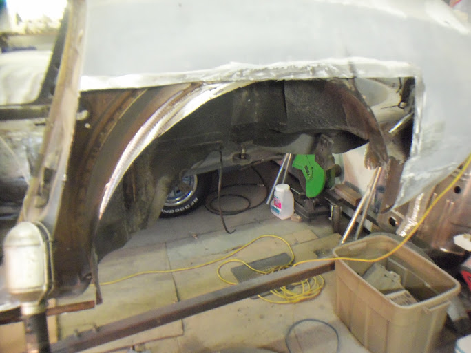

Fitting and trimming inner fender.
Perfect **** weld gap.

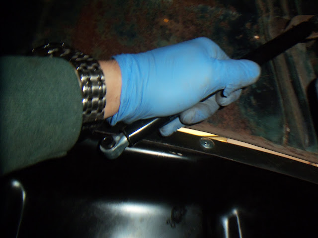

Tools.
Dash is perfect, so I'm trying to keep it that way.

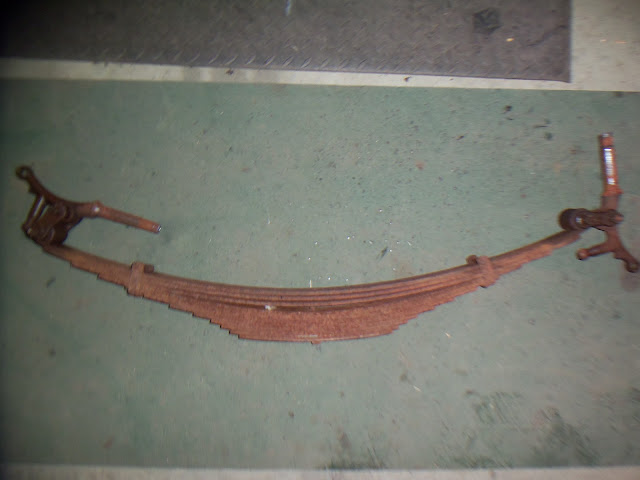

Yesterday I pulled the front suspension for the rod into the shop, again using the electric puller. I love this thing!
This thing REALLY comes in handy to pull stuff in and out of the shop, especially when there's snow on the ground! I attached to the the axle, tied it down to a nearby tree and then puled the axle assembly across the driveway and next to the shop door. Then put the axle on skates to move it in the shop -

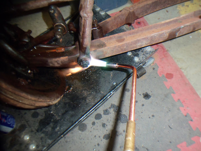

I doused it with penetrating liquid and left it overnight -
That's a whack of leaves! When I take some out I'll be able to make some spoons for metalworking.
This thing is incredibly original.

Like trying to remove the seriously rusted bolts from the perch pins on my 32 front end -
But they wouldn't budge - so now I'm 2 for 2.... time to turn my attention to my third project of the day....repairing the front wheel on the kids Xmas ornament...

Tore the 32 front end down today - lots of heat used, as well as this tie rod tool, which made short work of the joints -
images
Everything was in good shape, including the brakes and backing plates - the shoes even have about 80% pad left on them!
