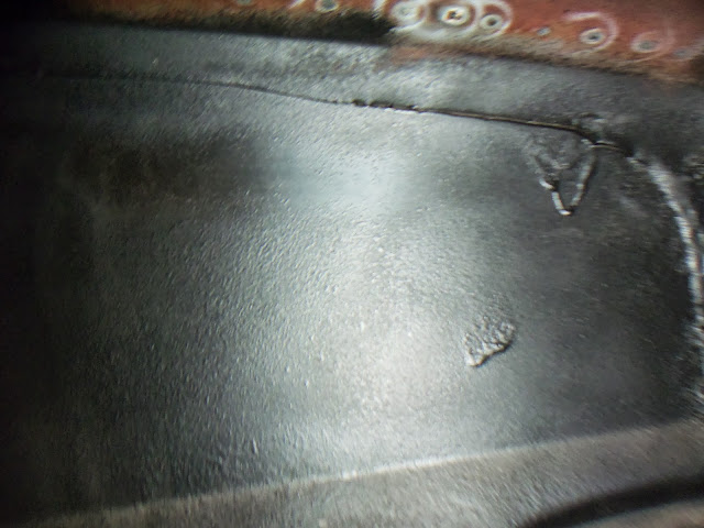

While waiting on some sealant and the tinter for the 240, I got a start on the Camaro -
The trunk fit so well I decided to drill some alignment holes. I don't always do this, but When something fits well it's worth it to keep it that way!
The car must have been in "moist" storage. Trunk floor has newer rust stains from parts that were stored inside it. Hopefully the floor under the black paint and sealant isn't much worse -
The moisture rusted any exposed metal, like these pieces under the trunk spoiler - :dunno:
Here's how the first restoration was done.....and if you know what you're looking at, well....nuff said. :eyecrazy:
But if you need some help, the last hackers just chopped the original quarters off "somewhere in the middle", then stuck repopped quarters on over top, filling the overlaps with filler. The worst kind of restoration for sure.
:sad:
This is never a good sign.....add-on weather-stripping to seal the lid against the trunk rubber:

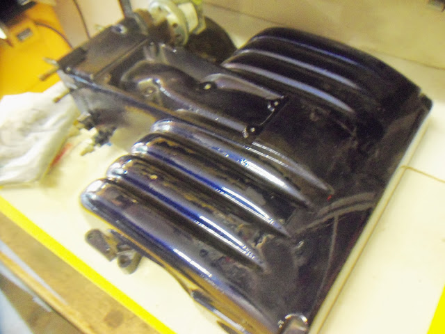

FINALLY!! :thumbup: Color on the 240Z today - inners anyways. Hopefully complete it on Sunday. The local jury is still out on the color (Mrs E-tek and Colt had plenty to say :wtf:), but I think it'll be fine. I didn't over-think it and of course had to use Dupli-Color's pre-mixed colors, but even so, I made up my own shade with a 4:1 custom mix of their Brilliant Aluminum and Deep Blue Metallic colors.
I got started at 9am to catch the coolest part of the day, but by the time I got through applying the primer sealer, then the base, then clear, it was an 8 hour process and the clear was STILL going on at 2PM and it was 30C....
First up - final masking (9am 21C/74F)
Sealed up, ready for final wipe and tack: (10:45am 22C/76F)
First application - Primer Sealer: (11:15am 25C 82F)
While the Primer Sealer (large can in back) flashed, I mixed my base color:
The Deep Blue Metallic was mixed into the Brillaint Silver:
As I had decided on a 4:1 mix ratio, I just used the appropriate mixer gradient on the mixing cup:
The new, custom color. That's a TON of metallic.... (12:00PM 28C/88F)
The re-coat windows were considerably shortened due to the temperature in the shop, so - after a bunch of test sprays to set up the gun were shot - on went the base coat: (1PM 30C, 92F)
Me likey - but Colton wasn't so sure.... :bounce: Oh well, time for the clear coats: (31C, 94F)
A couple hours later and the floor was dry and we could open the doors:
Tomorrow I'll tear off all the masking paper, Lower it down on the rotisserie, install the doors, hood and hatch, wet-sand all the overspray, then re-mask and seal it all up - again. Hopefully I can shoot the outer on Sunday and be done with for a while. I have to leave it for a while anyways before color sanding it and I really want to tear down the Camaro so that when the body parts come I can get right on it.
:thumbup:

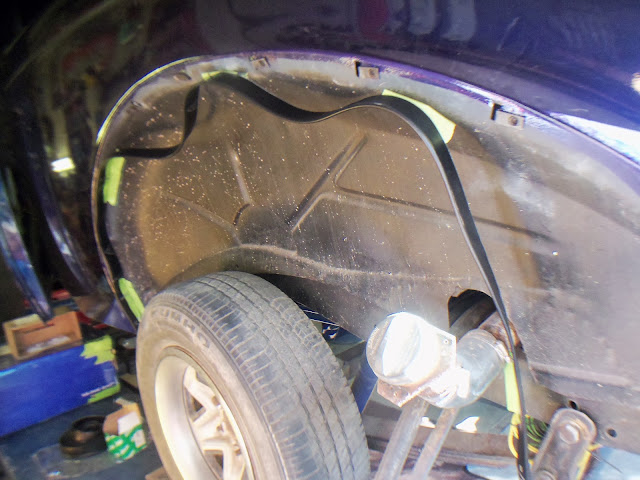

Installing the Fender Welting on the rear fenders is a major PAIN - but with enough patience (and effort!) it turned out nice.
After measuring it against the body of the car, I marked the bolt holes and where I wanted the pie cuts, in order to get the smoothest overall look with the curves in the right spots.
I then used a hole punch to open bolt holes.
After a ton of adjustments, they came out OK:
The left side needed an extended vent tube so I got that done while the fender was still off:
Fenders on! Look at the shine on this thing!
This color is exactly what the owner wanted - light in the sun (here with a flash) and dark in low light (no flash):
And check out the hood!!
.... then just imagine it after the wetsand and polish and with some chrome!
