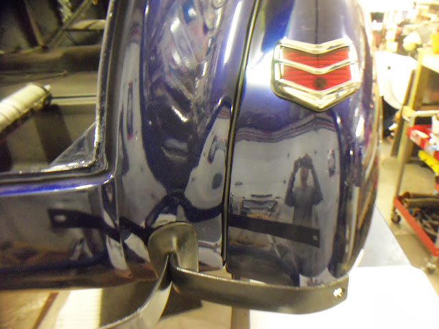

I had to recall something I learned a long time ago - cars went from no lights in back, to brake lights only, then - much later - signals were added. So when you throw a pair of original lights back on a 40 Ford (for example), the twin-filament (1157) bulbs will not fit as they have offset side pins (not talking about the contact points on bottom), whereas the brake-only bulbs have equal-offset pins (1156). Basically, the entire bulb socket needs to be changed out, not just the electrical connections, to properly hold the required twin-filament bulbs.
As I'm kinda working back-to-front, I cleaned up then painted anything that wasn't already black, inside the back hatch. It'll all be covered by upholstery, but I'm a details-man....

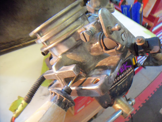

Then (of course!) I got distracted when I saw the build-up on the TB, so I soaked and cleaned that while I was doing other stuff:

Bumper brackets. I've learned to always use WD40 every time I try to slide rubber over metal (or vice versa)....I always think I should keep some in the bedroom ;)!!
I also used a piece of shin paper in between to avoid scratching them:
