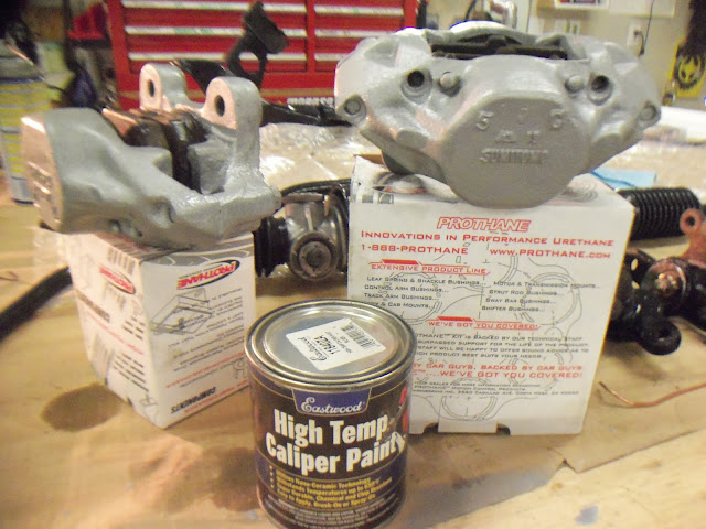

Today was paint day - and another way to use your 4-post lift: as a quick set-up paint booth!
Inner window garnish moldings for 40 Ford:
240Z front suspension/bake parts:
Rebuild should be fun with ALL new parts (and urethane bushings!):

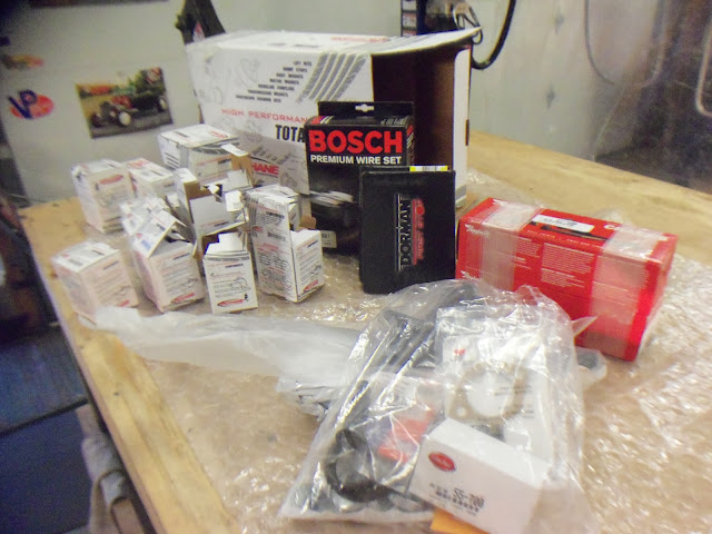

Had to buy a new gallon of MetalPrep (Phosphoric Acid soln) yesterday for the Camaro sub structure and MAN has the price ever gone up! Used to be under $40/gal, now it's $65! Oh well, certainly worth the extra step to truly neutralize any old/hidden or surface rust:
The white phosphate coating already on there was from the first application. I did 3 in total:
Quarter panel sits patiently while I await the new roof panel and hinges for the drivers door.
While I'm waiting on that stuff, I'll be able to get a move on the 240!
Check out the difference between the old and new Urethane bushings:

Also got some more bits readied to put the 240Z front end together. Trying to get as much as I can done while waiting on the Camaro parts and before the 40Ford returns for some finalizing!

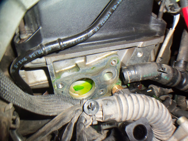

After taking care of my sick kids the first few days of the week, I caught up over the last couple days!
Mrs E's Mini Cooper blew it's thermostat seal....hard as HELL to get at - like everything on these cars...
I'm doing the same fix on a '03 Beetle. Did you buy the Mini gasket or use a RTV product? The Beetle uses a simple rubber ring that doesn't look perished in any way, but still leaks
Same - looks ok, but leaks! I'll buy the seal and t-stat, which come as one. I read that these housings crack quite often, but this one looks ok. Not an app where RTV would suffice.

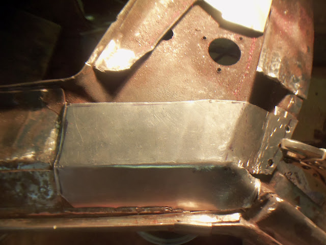

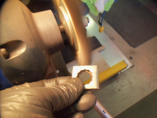

Made the pieces needed to repair the worst part of the Camaro's roof substructure:
Drill and chisel, drill and chisel ;)
Bottom piece:
Top piece:
Nearly ready to weld:
